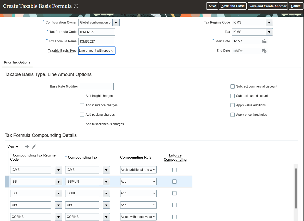

Use the Line amount with special rate factor and base adjustment as Taxable Basis Type in the Create Taxable Basis Formula page to enable the Compounding Rule column.
Select the appropriate Compounding Rule:
  • Add - Add the tax to the line amount to compound the taxable basis.
  • Subtract - Subtract the tax from the line amount to compound the taxable basis.
  • Adjust with negative special rate factor - Subtract the line amount with a special rate of 1/(1- special rate%).
  • Adjust with positive special rate factor - Add a special rate of 1/(1- special rate%) to the line amount.
  • Apply additional rate with special rate factor - Add a rate of (1+additional rate%)/(1- special rate% * (1+additional rate%)) to the line amount.
NOTE: If the selected Taxable Basis Type is Line amount with special rate factor and base adjustment, all the inclusive taxes added to the Tax Formula Compounding Details section must be configured to use the standard inclusive handling method.
