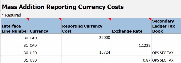

    In the FA_MC_MASS_RATES sheet, you can enter either the asset cost in the tax book’s currency or the applicable conversion rate using the new ‘Secondary Ledger Tax Book’ column. For corporate book asset conversions, you can also specify these values for any related reporting currencies and secondary ledger tax books. The mass copy process will use the provided data when assets are copied from the corporate book to the tax book. For assets added directly to a tax book, simply enter the cost or conversion rate, and the asset addition process will apply it. The template also supports multiple source lines for a transaction, with different rates for each if needed.
FA_MC_MASS_RATES
