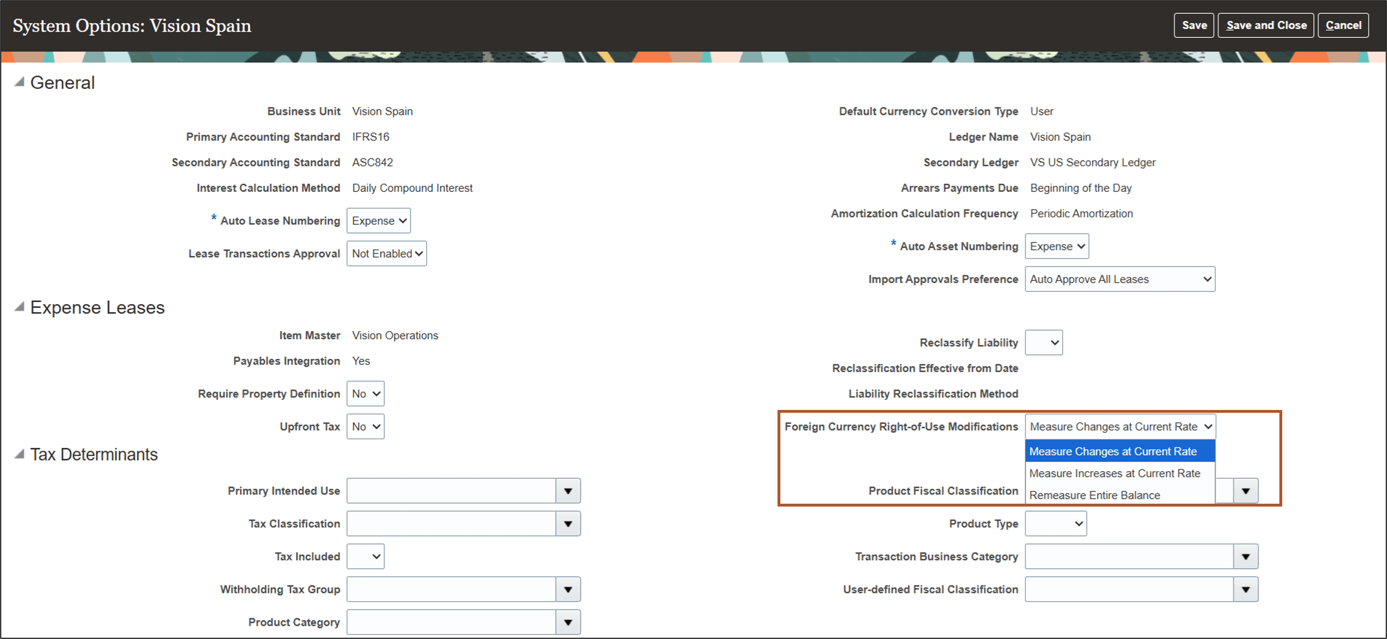

Configure the system to measure either the incremental change or the entire right-of-use asset balance, in line with your accounting policies or local regulations. Select from one of three methods to manage foreign currency right-of-use asset modifications:
  • Measure Changes at Current Rate: Applies the current conversion rate on the amendment date to convert changes (increase or decrease) in the right-of-use asset balance to the ledger currency on lease amendments. Reductions to the right-of-use asset balance on impairments and terminations use the blended historical rate.
  • Measure Increases at Current Rate: Applies the current conversion rate on the amendment date to convert increases in the right-of-use asset balance on lease amendments. Reductions to the right-of-use asset balance on amendments, impairments, and terminations use the blended historical rate.
  • Remeasure Entire Balance: Applies the current conversion rate on the amendment date to remeasure the entire right-of-use asset balance on amendments, impairments, and terminations.
When processing events such as amendments, impairments, or terminations the system converts amounts using the appropriate current or blended historical rates based on the selected configuration. The system maintains a blended historical rate for each right-of-use asset, reflecting the weighted average of rates applied during booking and subsequent modifications. The blended historical rate ensures monthly amortization entries are converted to the ledger currency considering the different rates that have been applied to the right-of-use asset changes.

To enable this feature:
  1. Navigate to the Manage Lease Accounting Configuration for the relevant business unit.
  2. Locate the Foreign Currency Right-of-Use Modifications system option.
  3. Select one of the available methods based on your organization’s accounting policy.
The following screenshot describes configuring the Foreign Currency Right-of-Use Modifications system option:
Configure System Options page
