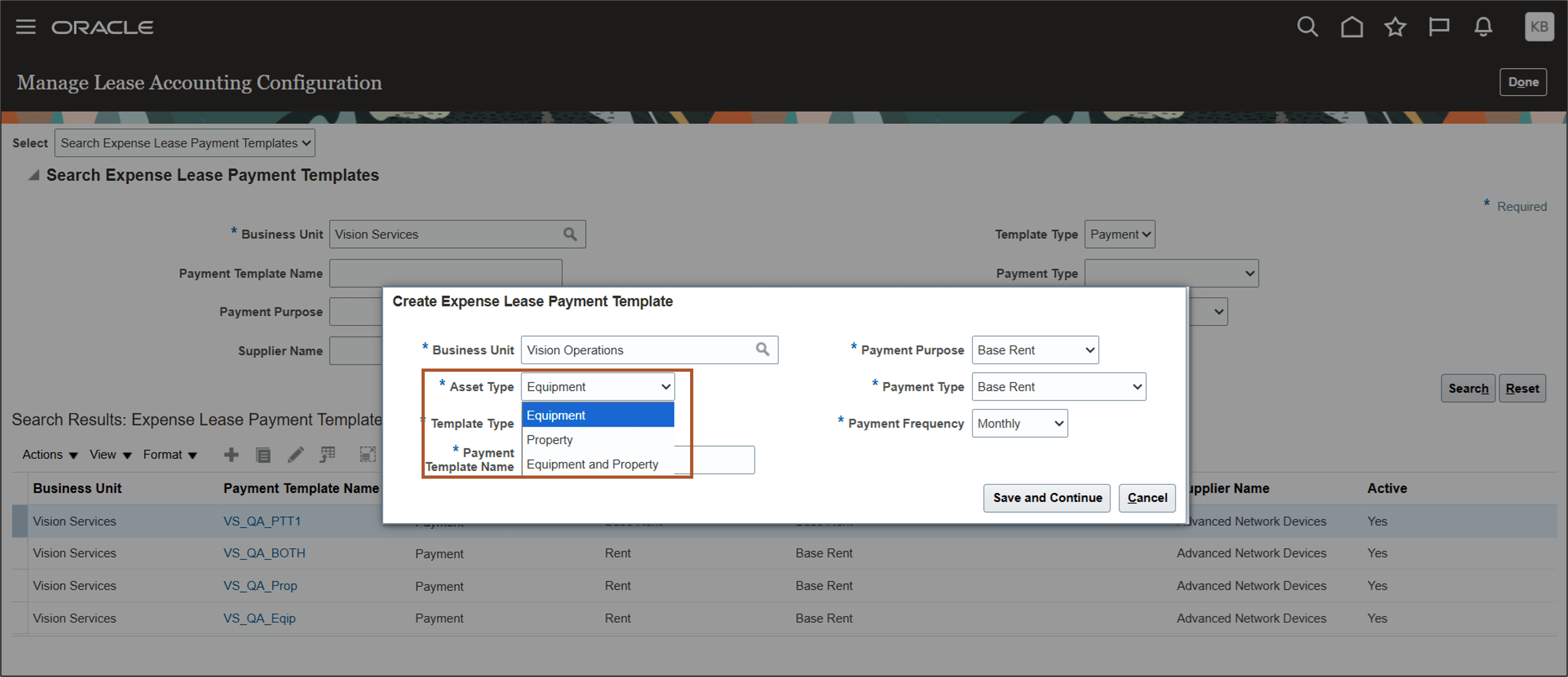

  1. Navigate to Setup and Maintenance and select the task Manage Lease Accounting Configuration.
  2. Navigate to Search Expense Lease Payment Templates to create a new expense lease payment template.
  3. Select Asset Type:
    • Equipment: Indicates that the template may only be used for creating payments on an equipment lease.
    • Property: Indicates that the template may only be used for creating payments on a property lease.
    • Equipment and Property: Indicates that the template may be used for creating payments on both equipment and property leases.

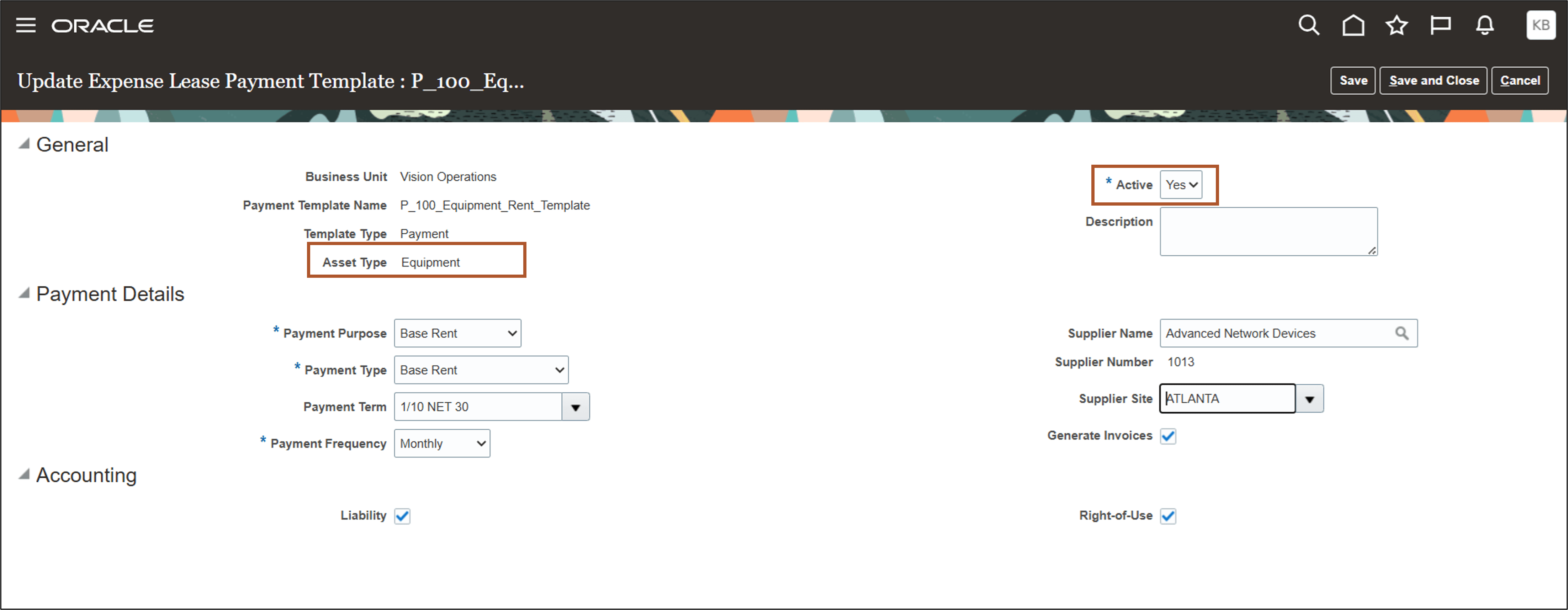

  4. Enter required attributes and update the template status to Active.

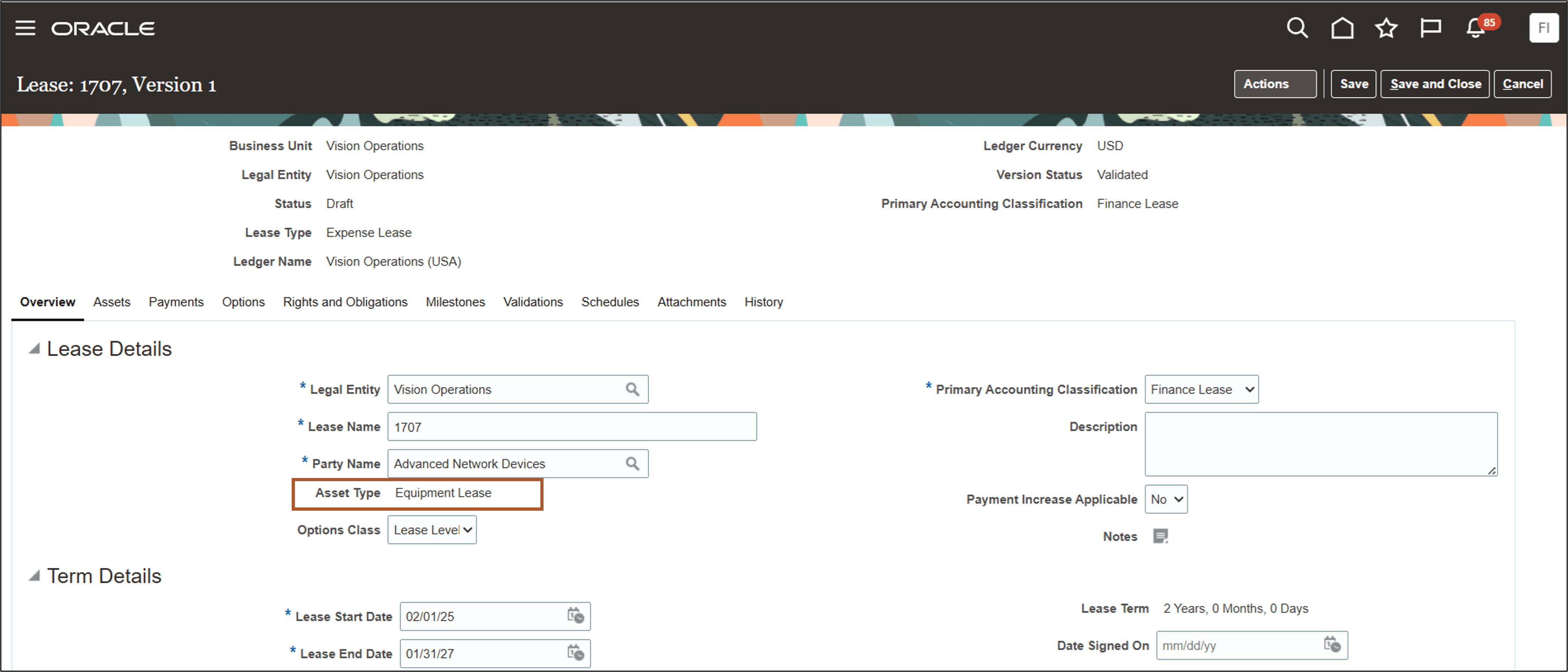

  5. Create an expense lease and add an asset to the lease.

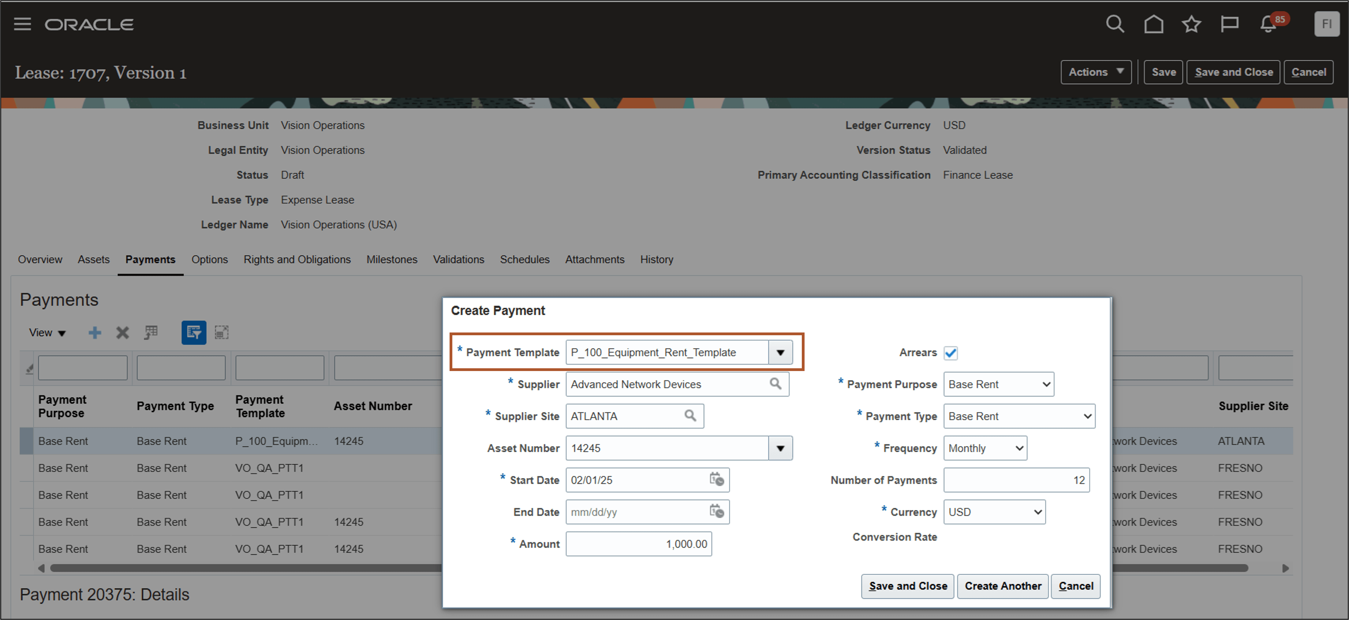

  6. Navigate to the Payments tab and create a payment.
  7. The list of values for Payment Templates displays templates filtered based on the asset type selected on the lease.

Create Expense Lease Payment Template page
Update Expense Lease Payment Template page
Expense Lease Details page
Create Payment page
Create Payment page
