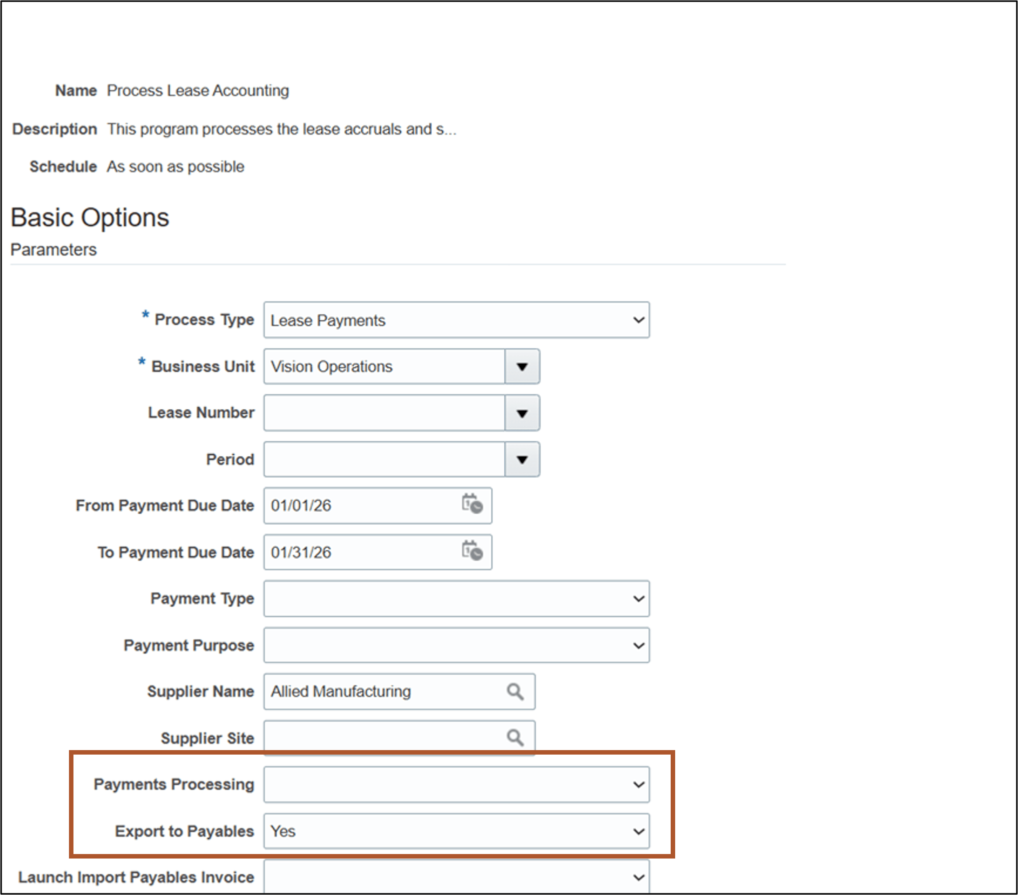

To schedule the Expense Lease Payments process to export only approved payments to Payables:
  1. Select Process Expense Lease Payments from the side-panel.
  2. Complete the below parameters according to your requirements to identify the payments to be processed:
    • Business Unit: Mandatory. Select a Business Unit.
    • Lease Number: Optional. Select a Lease Number to process payments for a specific lease.
    • Period: Optional. Select a Period to process payments for a specific period.
    • From and To Payment Due Date: Enter From and To Payment Due Dates to process payments for a specific payment due date range.
    • Payment Type: Optional. Select a Payment Type to process payments for a specific payment type.
    • Payment Purpose: Optional. Select a Payment Purpose to process payments for a specific payment purpose.
    • Supplier Name: Optional. Select a Supplier Name to process payments for a specific supplier.
    • Supplier Site: Optional. Select a Supplier Site to process payments for a specific supplier site.
  3. Leave the Payment Processing parameter blank. This enables exporting only previously approved payments to Payables.
  4. Select Export to Payables as Yes to export the selected payments to Payables.
  5. Select Launch Import Payables Invoice as Yes to launch the import of the Payables invoices.
  6. Submit the process.
The following screenshots describe the process of scheduling the Expense Lease Payments process to export only approved payments to Payables:
Side-Panel - Process Expense Lease Payments
