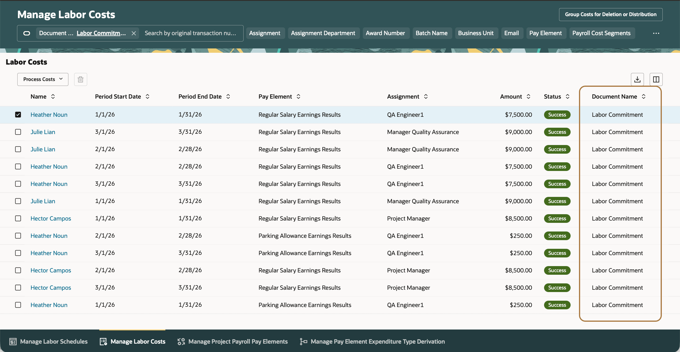

The Document Name attributes has been added to the Manage Labor Costs page to differentiate commitments from actual payroll costs.
Manage Labor Costs Labor Commitments

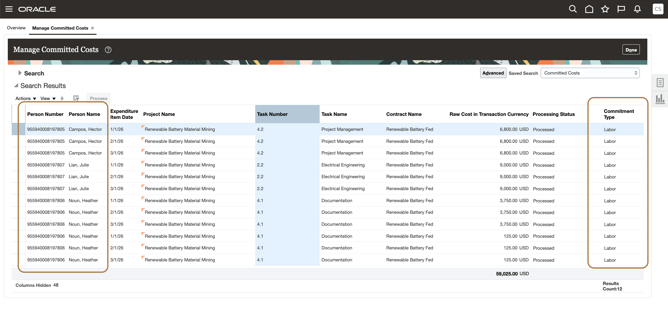

The Manage Committed Costs page has additional person attributes to identify the distributed labor commitments.
Manage Committed Costs Labor Commitments
