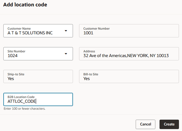

  1. Follow these steps to set up and use your Messaging Location Codes:
  1. Select Partners from the in-app navigation bar.
  2. On the Customer Messaging Properties tab, select Messaging Location Codes.
  3. On the Messaging Location codes page, select Add.
  4. Enter the customer details. Note that the Site Number displays only customer sites that don’t already have a location code assigned. The Ship-to Site and Bill-to Site fields reflect the site’s defined address purposes.
  5. Select Create.

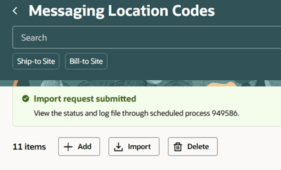

  1. As an alternative to adding location codes manually, you can import them using a .csv file.
The .csv file must include three columns with the following column headers (in any order):
Column Header Description
CustomerNumber Identifies the customer number
PartySiteNumber Identifies the customer site number
LocationCode Identifies the location code
    1. On the Messaging Location codes page, select Import.
    2. Drag and drop the .csv file and select Import.
Import Location Codes
A message displays the scheduled process ID, which can be used to monitor the import status on the Scheduled Processes page.
Messaging Location Codes - Import request submitted message

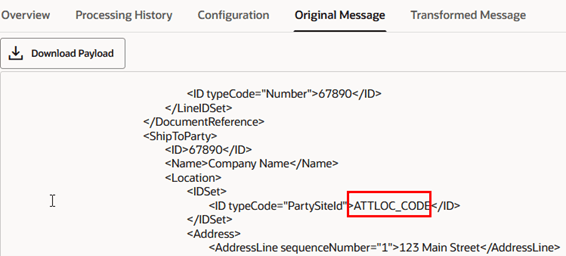

  1. To process a message like an inbound order, update the payload to include the required location codes at the Xpath locations specified in the table.
Original Message Payload

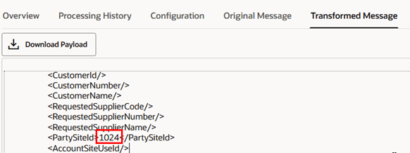

  1. Once the message is processed, the transformed file will contain the expected values at the Xpath locations specified in the table.
Transformed Message Payload
