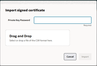

Import Signed Certificate
  1. Under Actions, select Import Signed Certificate.
  2. Select Import after you've added the details.

  7. The Import Signed Certificate updates the keystore entry, so the certificate is now Trusted (the Type changes from Self-Signed to Trusted) while continuing to use the same underlying private key.
