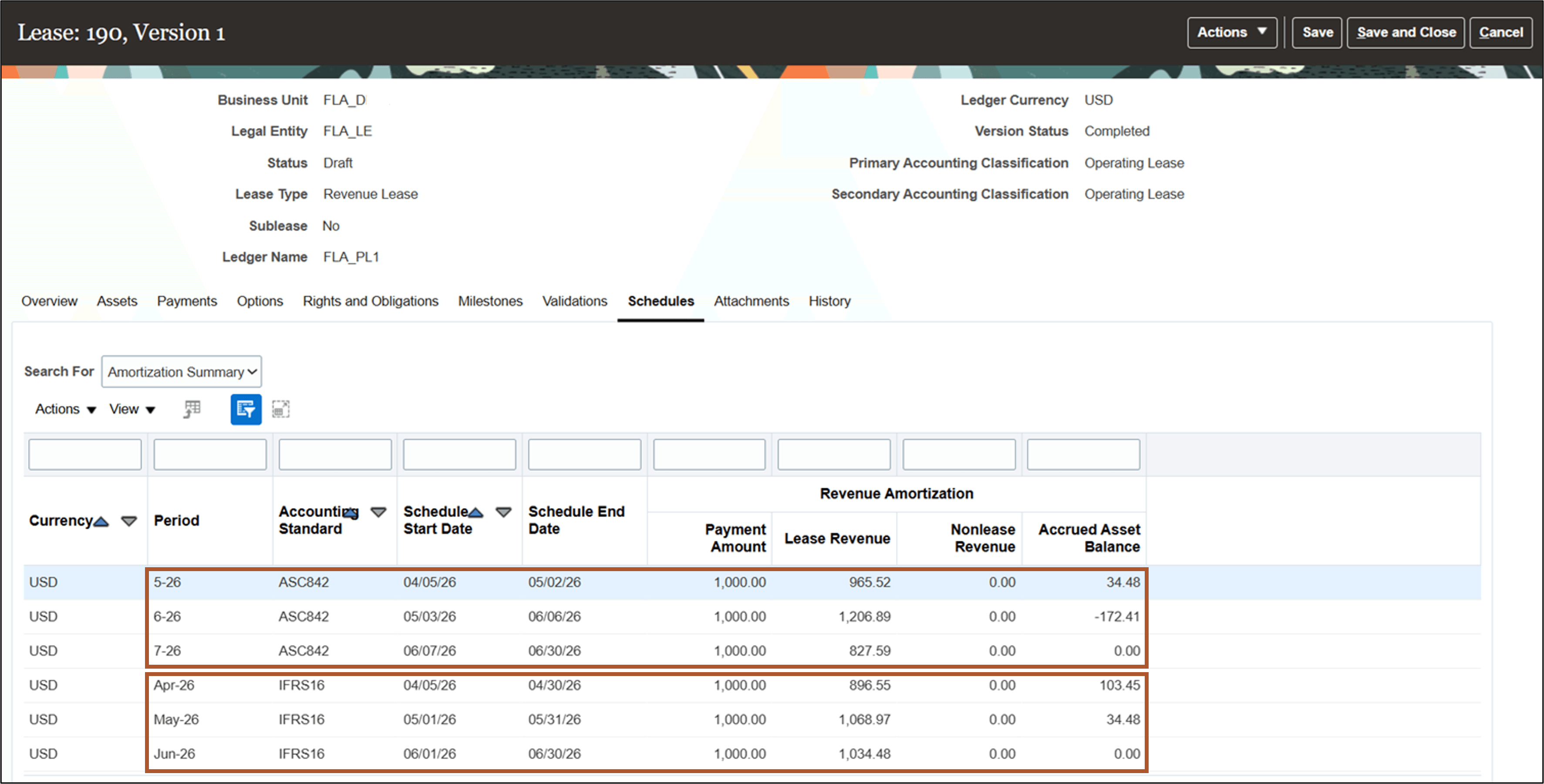

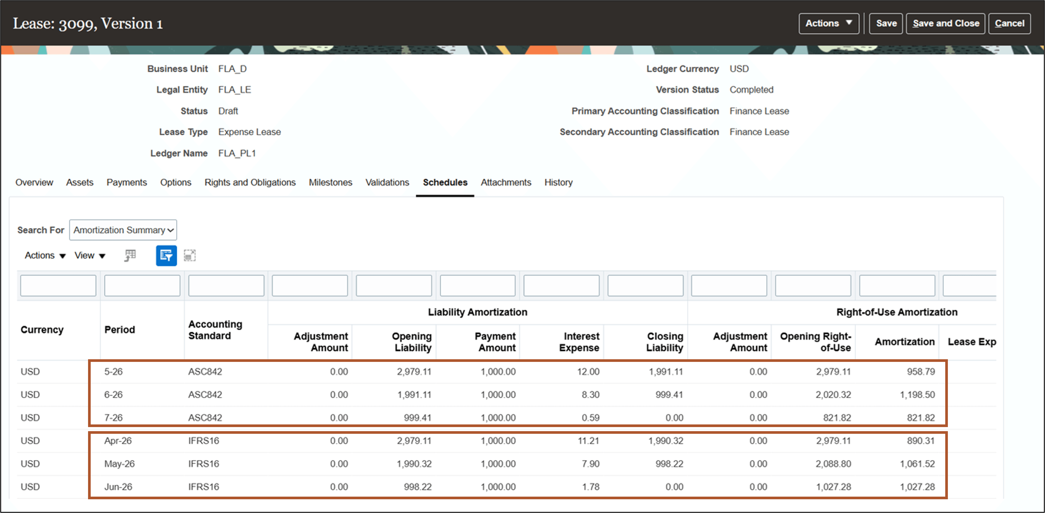

  4. Use the Schedules tab to review the amortization schedules calculated using the respective calculation calendars for the primary and secondary representations.

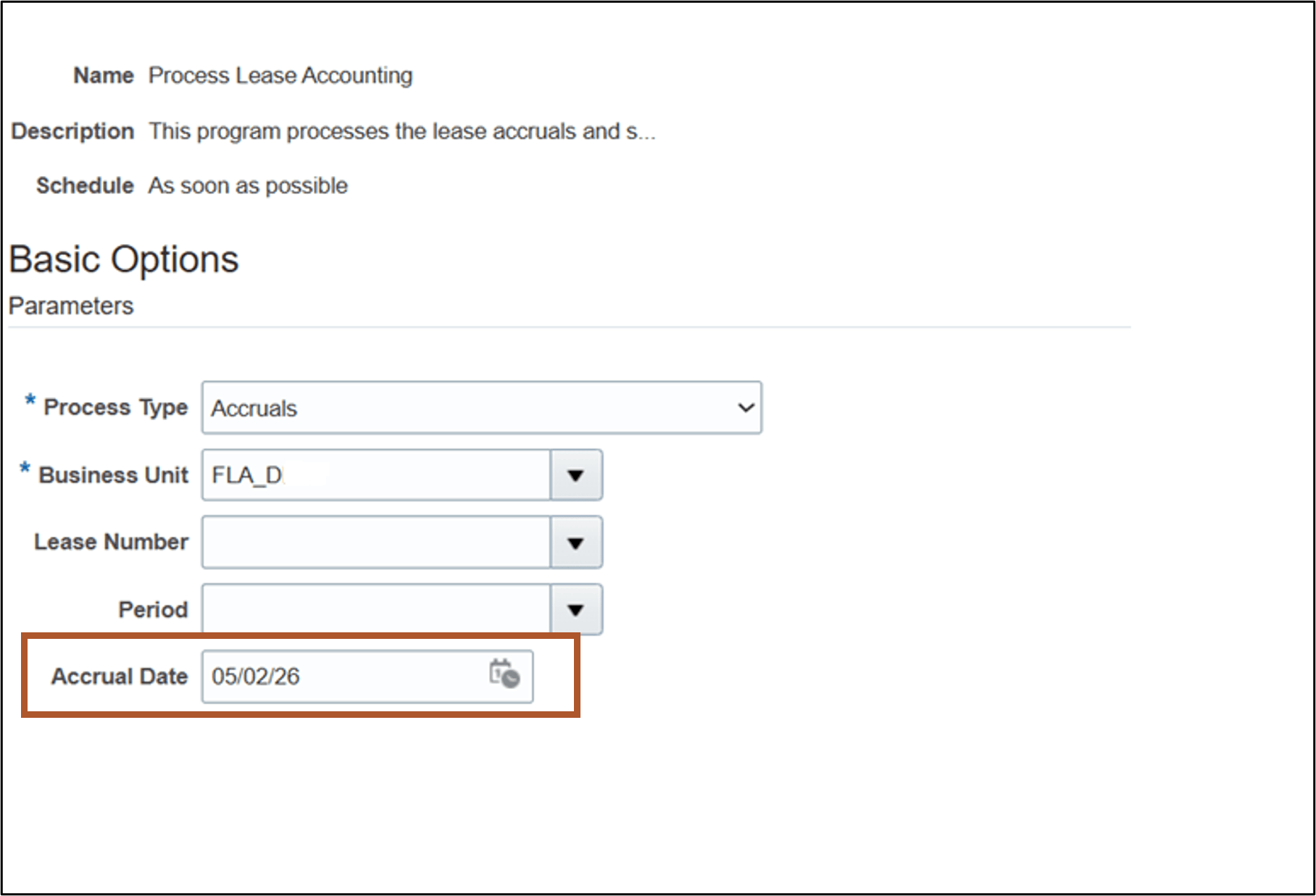

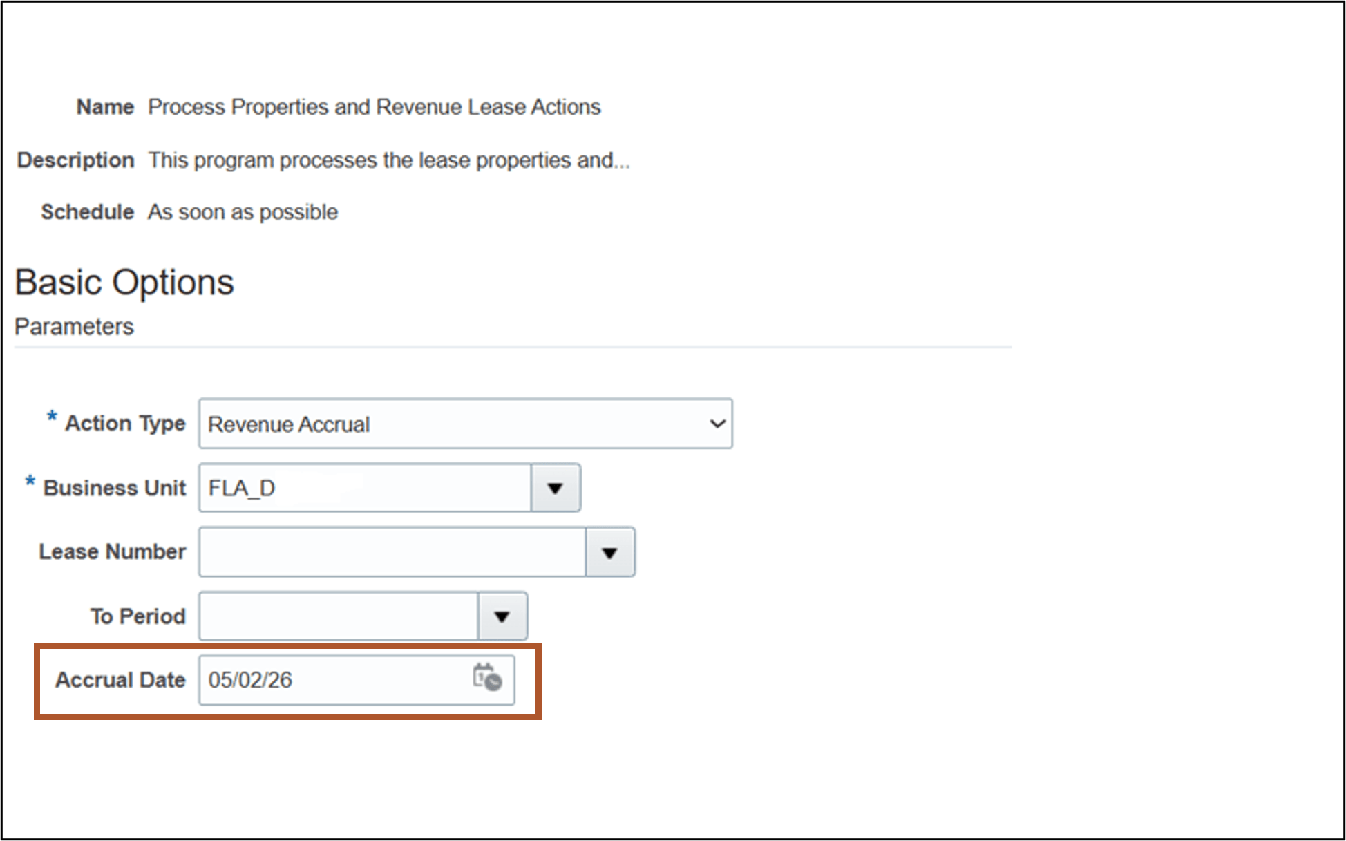

  6. Run the Process Lease Accruals program to create the accrual transaction and recognize the expense or revenue according to the schedule.
  7. Complete the below parameters according to your requirements to identify the leases and accounting periods to process accruals for both primary and secondary representations:
  • Business Unit: Mandatory. Select a Business Unit.
  • Lease Number: Optional. Select a Lease Number to process accruals for a specific lease.
  • Period: Optional. Select Period to process accruals till the selected period end date or leave blank to process accruals till the system date.
  • Accrual Date: Optional. Enter Accrual Date to process accruals till the Accrual Date.
The following screenshots describe viewing the lease amortization schedules by representation for expense and revenue leases:
Schedules - Amortization Summary
Expense Lease Schedules - Amortization Summary
Revenue Lease Schedules - Amortization Summary
The following screenshots describe the lease accruals process for expense and revenue leases:
Process Expense Lease Accruals
Process Accruals for Property Revenue Leases

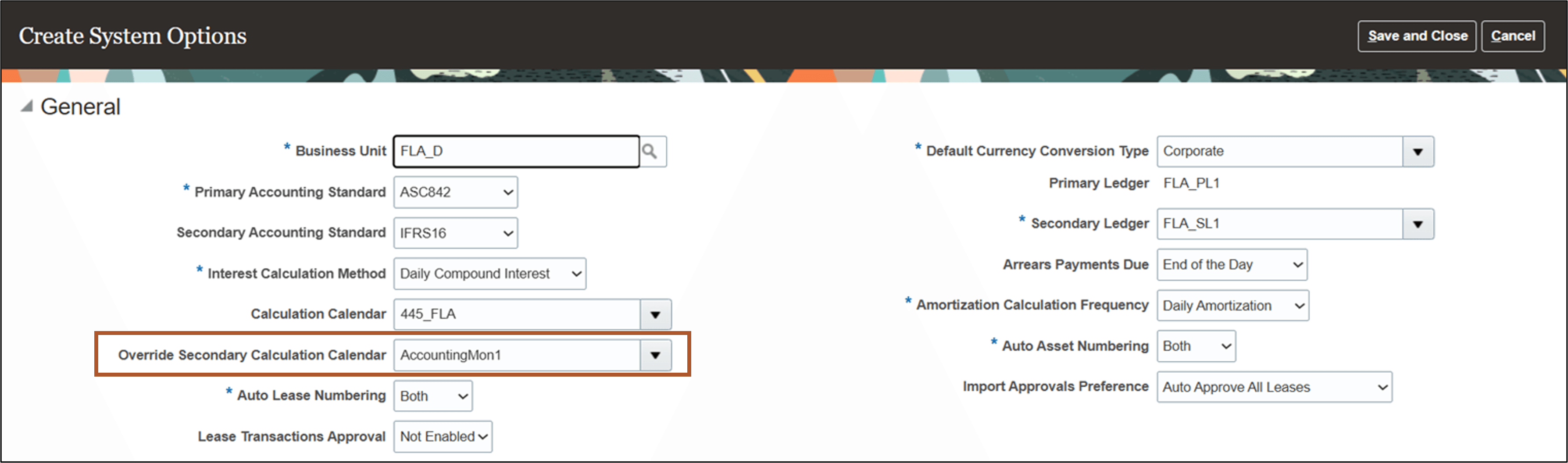

Steps to enable and configure
Complete these settings in Manage Lease Accounting Configuration:
  1. Navigate to the Create or Edit System Options page.
  2. Select the Primary and Secondary Accounting Standards and Ledgers.
  3. Select the Interest Calculation Method as Daily Compound Interest and the Amortization Calculation Frequency as Daily Amortization.
  4. Select the Calculation Calendar for the primary representation.
  5. Enter the Override Secondary Calculation Calendar to use a different calculation calendar for the secondary representation.
System Options page
System Options page
Tips and considerations
The Override Secondary Calculation Calendar system option is enabled for update only for those business units that do not have any active leases.
