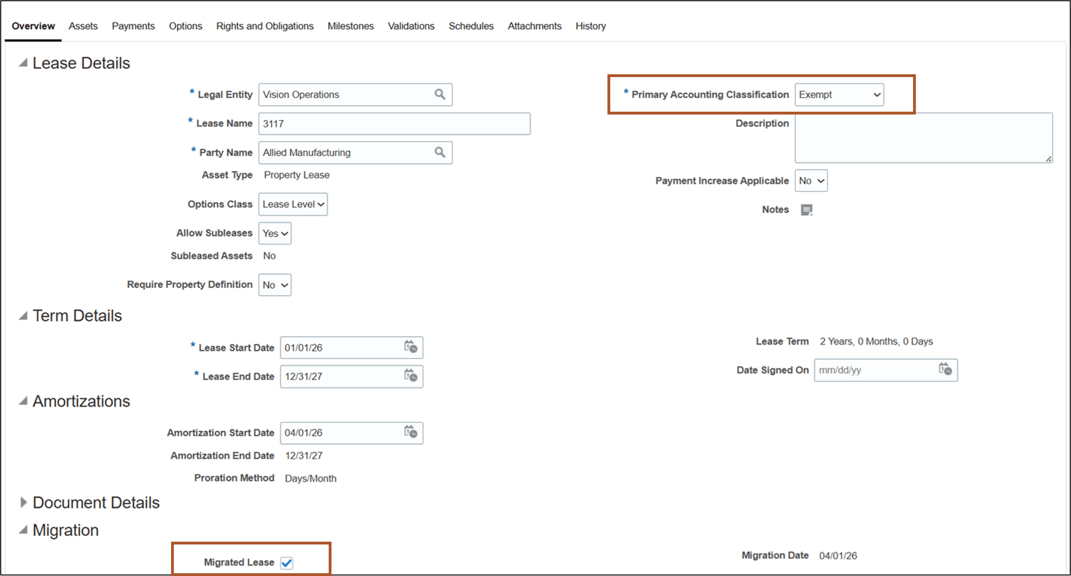

  2. Update lease details to enable the Migrated Lease option.

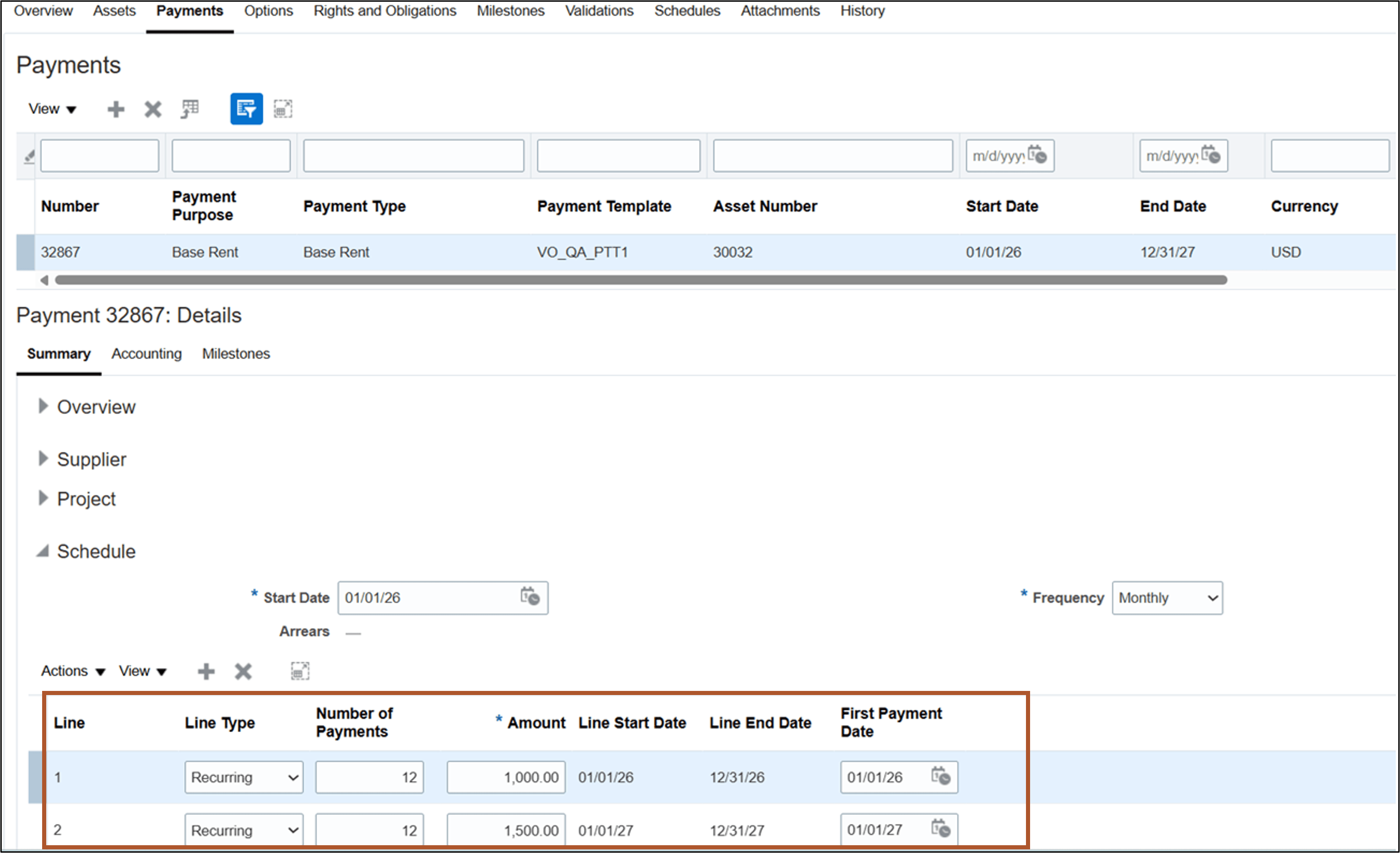

  3. Add an asset and an exempt payment to the lease. To add an exempt payment, the lease classification must be Exempt or the Right-of-Use and Lease Liability options on the payment must be unchecked.

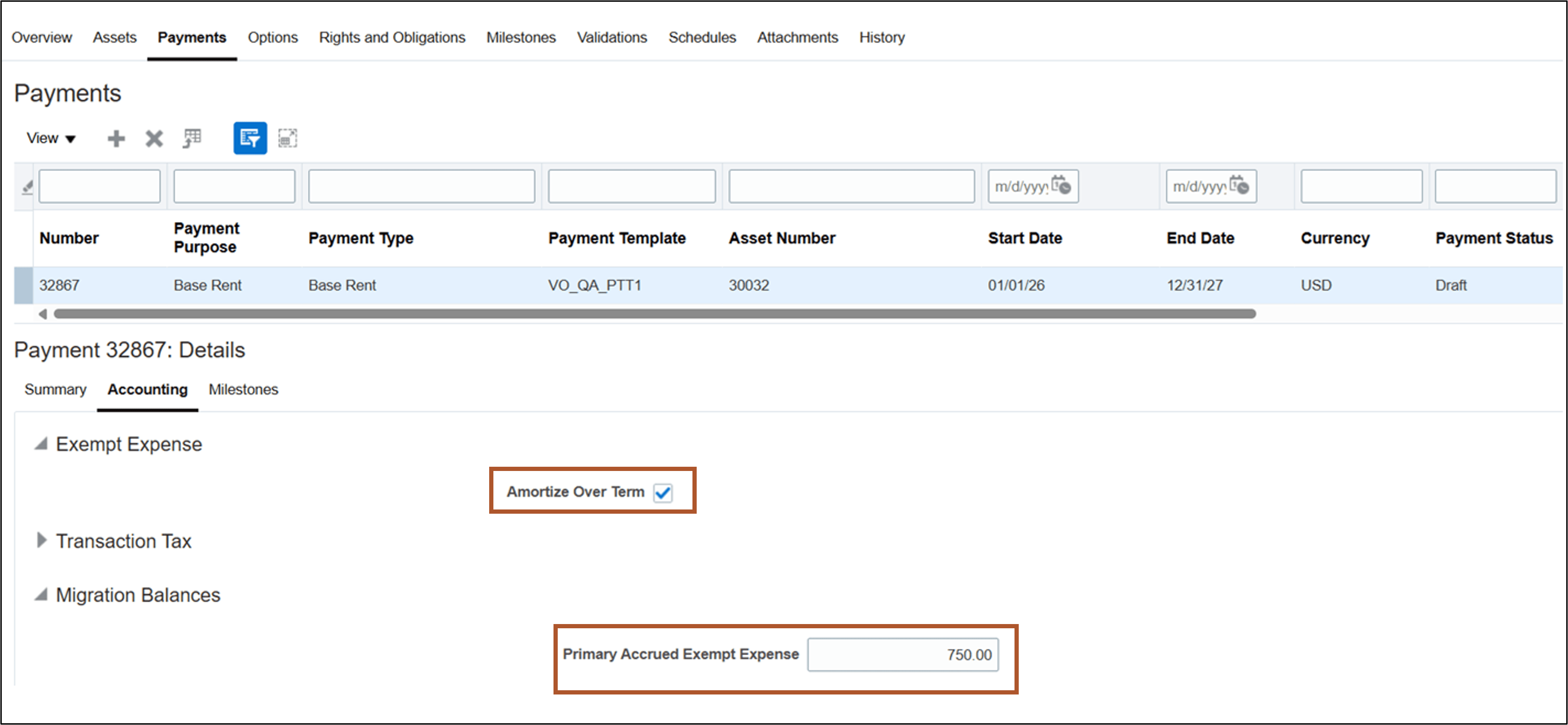

  4. Navigate to the Accounting tab in the Payment Details page.
  5. In the Exempt Expense section, select the Amortize Over Term option and enter the Accrued Exempt Expense for the Primary or Secondary representation as applicable under Migration Balances. The Accrued Exempt Expense is the difference between the exempt expense accrual and payment amounts prior to the Amortization Start Date.

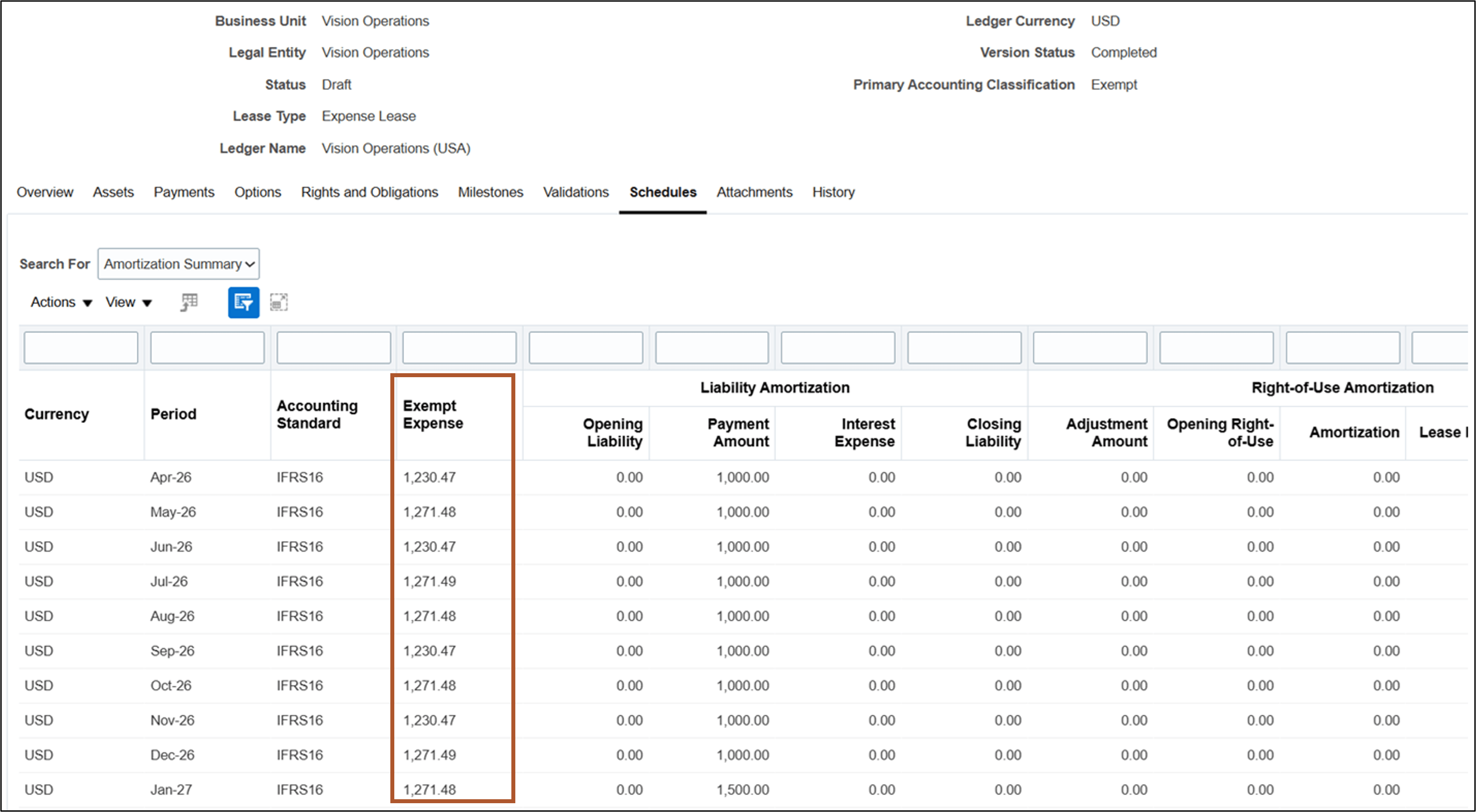

  6. Validate the lease and generate schedules.
  7. Use the Schedules tab to view the expense recognition schedule before lease activation.
The following screenshots describe the process of creating an exempt lease with accrued exempt expense migration balance:
Lease Details Page
Lease Details Page
Payment Details Accounting tab
Schedules - Amortization Summary
