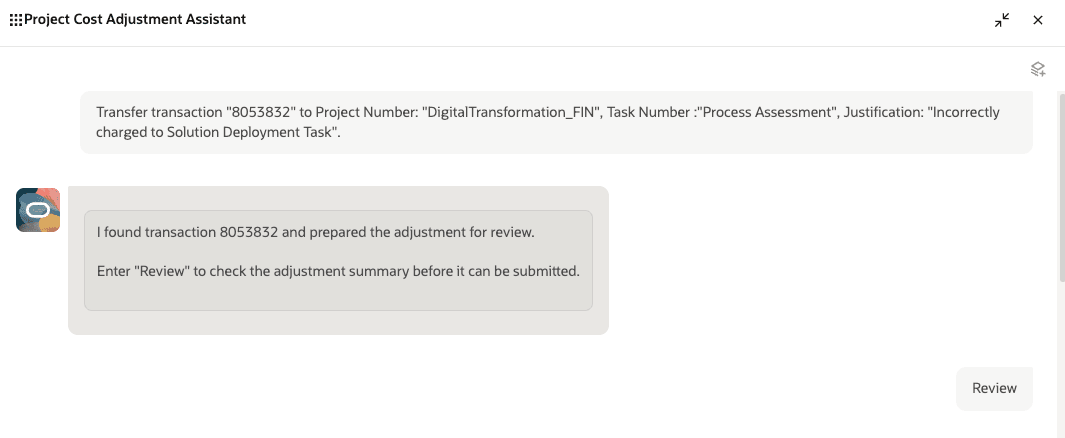

When the Transaction Number is Available
Transfer transaction "[Transaction Number]" to Project Number: "[Target Project Number]", Task Number: "[Target Task Number]", Justification "[Reason for adjustment]".
The assistant interprets the request, validates the transaction number, and confirms that the target project and task details are available before proceeding. Justification is optional and, when provided, is included in the adjustment.

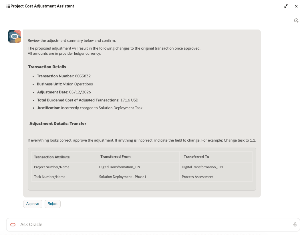

             Approve or Reject a project cost transfer adjustment after reviewing the prepared adjustment in the Project Cost Adjustment Assistant.
If the user needs to confirm transaction or related setup details before approving the adjustment, they can ask follow-up questions such as:

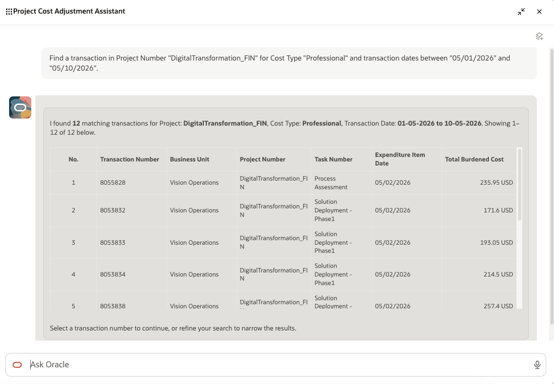

When the Transaction Number is not Available
Find a transaction in Project Number "[Project Number]" for Cost Type "[Cost Type]" and transaction dates between "[mm/dd/yyyy]" and "[mm/dd/yyyy]".
After identifying the correct transaction and confirming the target values, the assistant prepares the adjustment summary and seeks user confirmation. Once confirmed, it submits the request and informs the user of the status.
