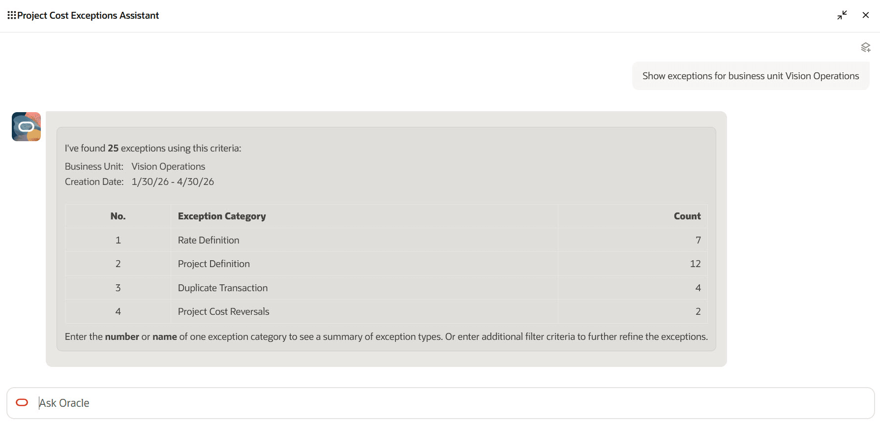

She navigates to the Agent Explore area and initiates the Project Cost Exceptions Assistant. She requests to see all unprocessed project cost exceptions for the business unit that is closing its project accounting period first.
The assistant retrieves all unprocessed project cost exceptions that meet her search criteria, groups the exceptions into meaningful categories, and displays this summary with record counts for each category.
Exceptions Summarized by Exception Category

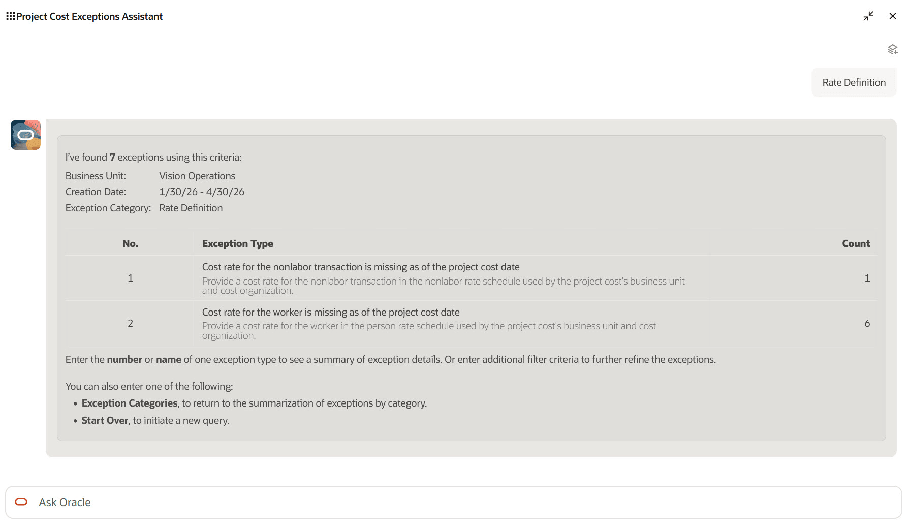

Katie wants to explore the exception types associated with the seven exceptions in the Rate Definition category. She enters either the name of the category or the corresponding row number in the table to instruct the assistant to drill down to the exception types for that category.
The assistant displays the seven exceptions by exception type, using the error message text to describe the reason for each exception. It also automatically adds the Rate Definition exception category to the filter criteria.
Exceptions for an Exception Category Summarized by Exception Type

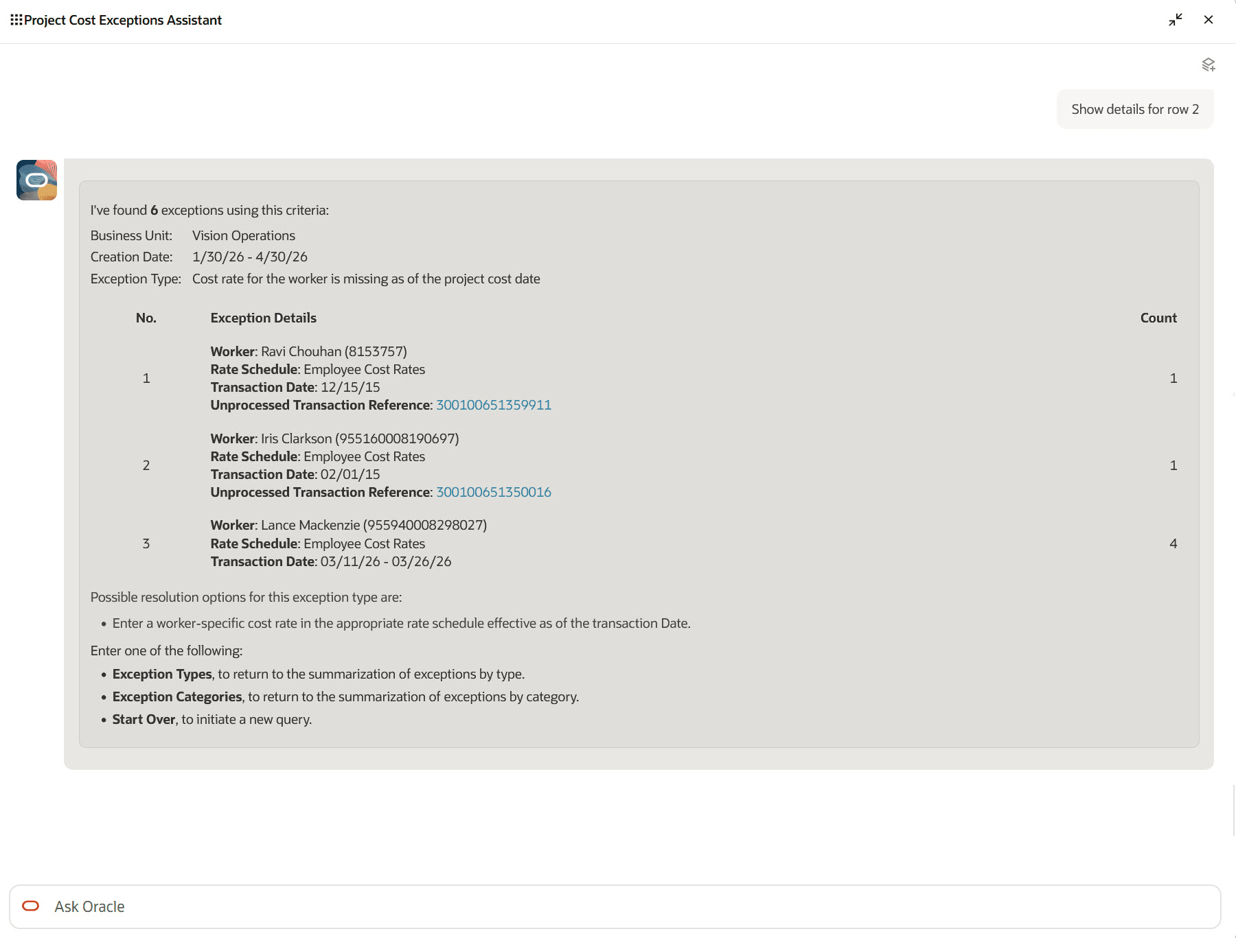

Katie wants to review details for the missing worker cost rate exception type, so she asks to display details for this type.
The assistant selects all missing worker cost rate exceptions and groups them by the key attributes relevant for that exception type: Worker, Rate Schedule, and Transaction Date (or date range). A deep link to the unprocessed cost transaction record in the Manage Unprocessed Costs page is provided whenever there's only one record found for a particular grouping.
Below the displayed exception details, the assistant lists the possible resolution options for the exception type.
Summarized Exception Details for an Exception Type
