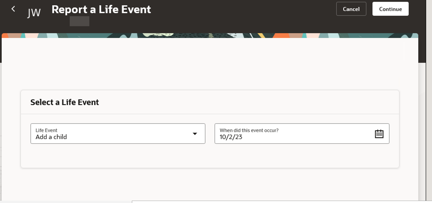

The Self-Service Benefits Self Report a Life Event page was recreated in the Redwood Toolset to improve the user experience by providing the same consistent functionality across Redwood pages. The functionality of the page remains the same.
Here’s how you use the Self-Service Benefits Self Report a Life Event Redwood page:
- On the Home page, click Me.
- Click the Show More link under Quick Actions.
- Search for Report a Life Event.
Self-Service Benefits Self Report a Life Event Page
This feature lets you experience Redwood’s high-fidelity interactions.
