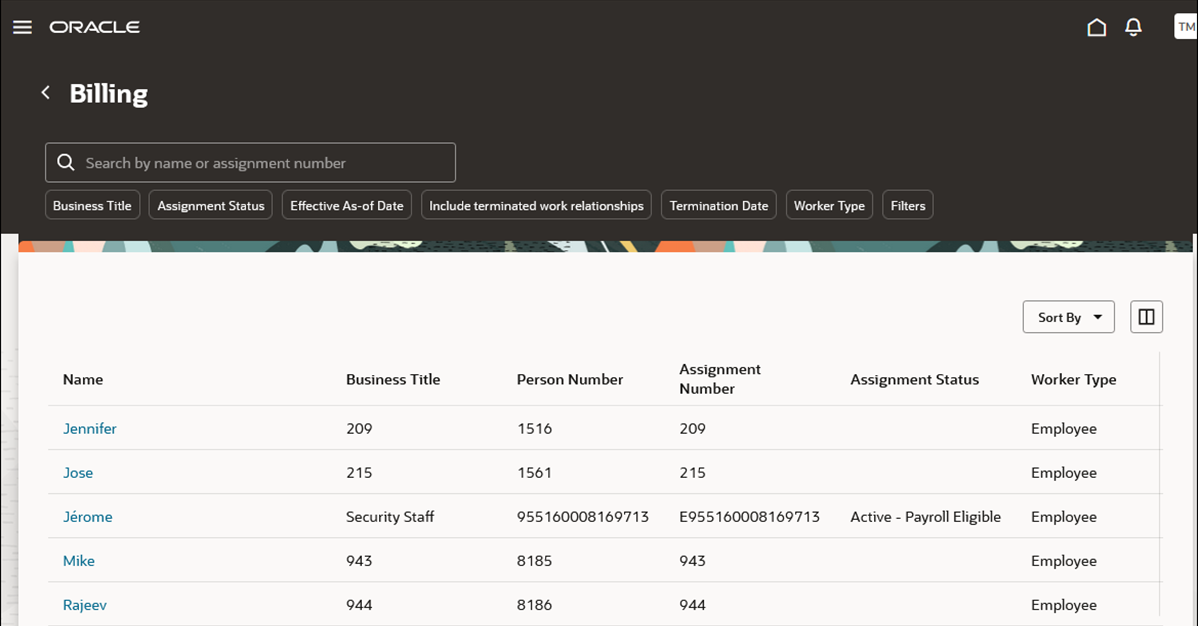

The Benefits Service Center Benefits Billing page was recreated in the Redwood Toolset to improve the user experience by providing the same consistent functionality across Redwood pages. The functionality of the page remains the same.
Here’s how you use the Benefits Service Center Benefits Billing Redwood page:
  1. On the Home page, click My Client Groups.
  2. Click the Show More link under Quick Actions.
  3. Search for Billing.
Screen capture of the Benefits Service Center Benefits Billing Redwood page.
Benefits Service Center Benefits Billing Page
This feature lets you experience Redwood’s high-fidelity interactions.
