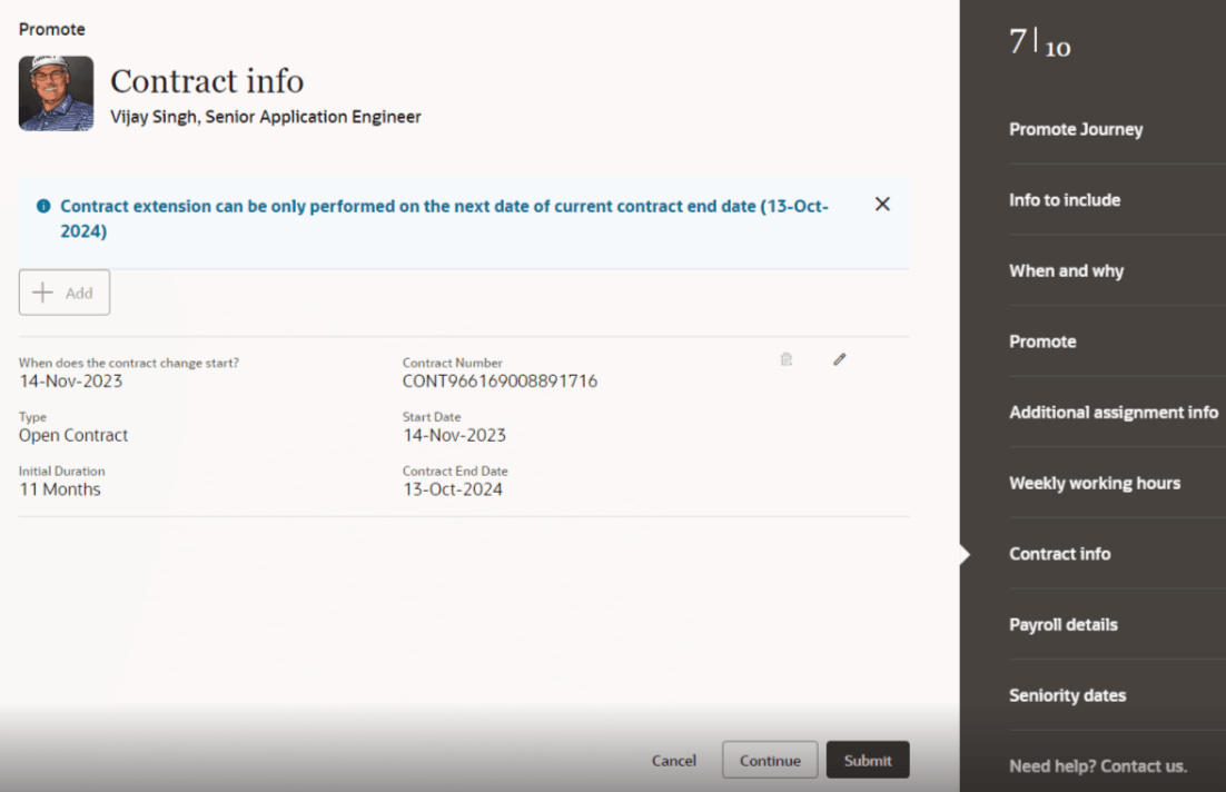

You can now use the Contract info step to either correct the contract, extend it, or add a date-effective update when updating a worker assignment. However, you can extend a contract only when the date selected in the When and Why step is contract end date + 1 day.
Only those contract records that share the same effective date with the assignment updates are available for correction on the Correct Employment Details page. Contract records that don’t share any effective dated rows with the assignment can be managed from the standalone Redwood Employment Contracts page.
Contract info step in Redwood Promote process
This feature gives line managers and HR specialists the ability to correct, extend, and add a contract when updating a worker's employment info.
