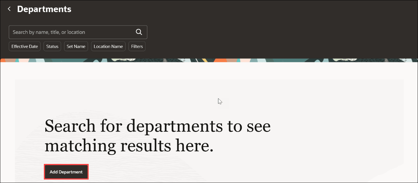

On the Departments search page, click Add Department.
Departments Search Page

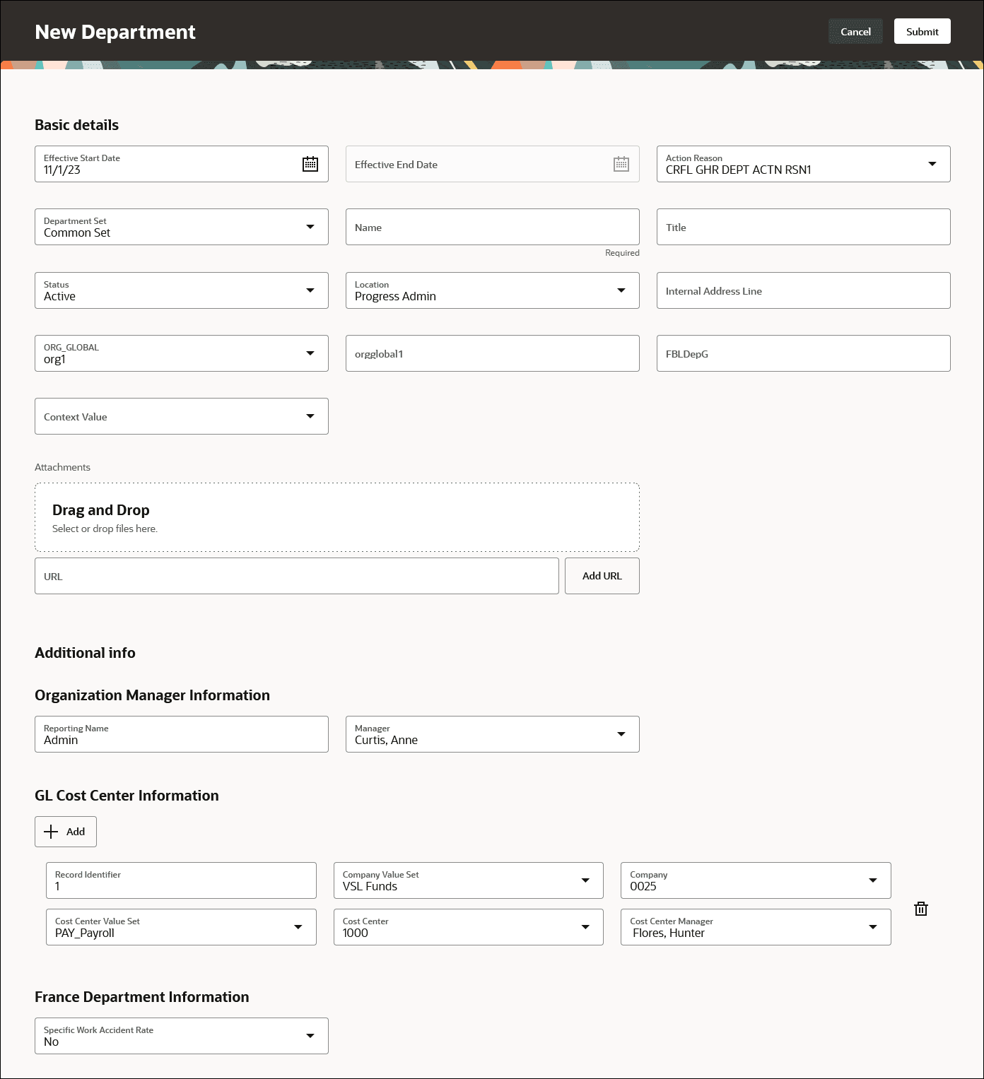

On the New Department page, enter the details as required and click Submit to create a new department.
New Department Page
New Department Page

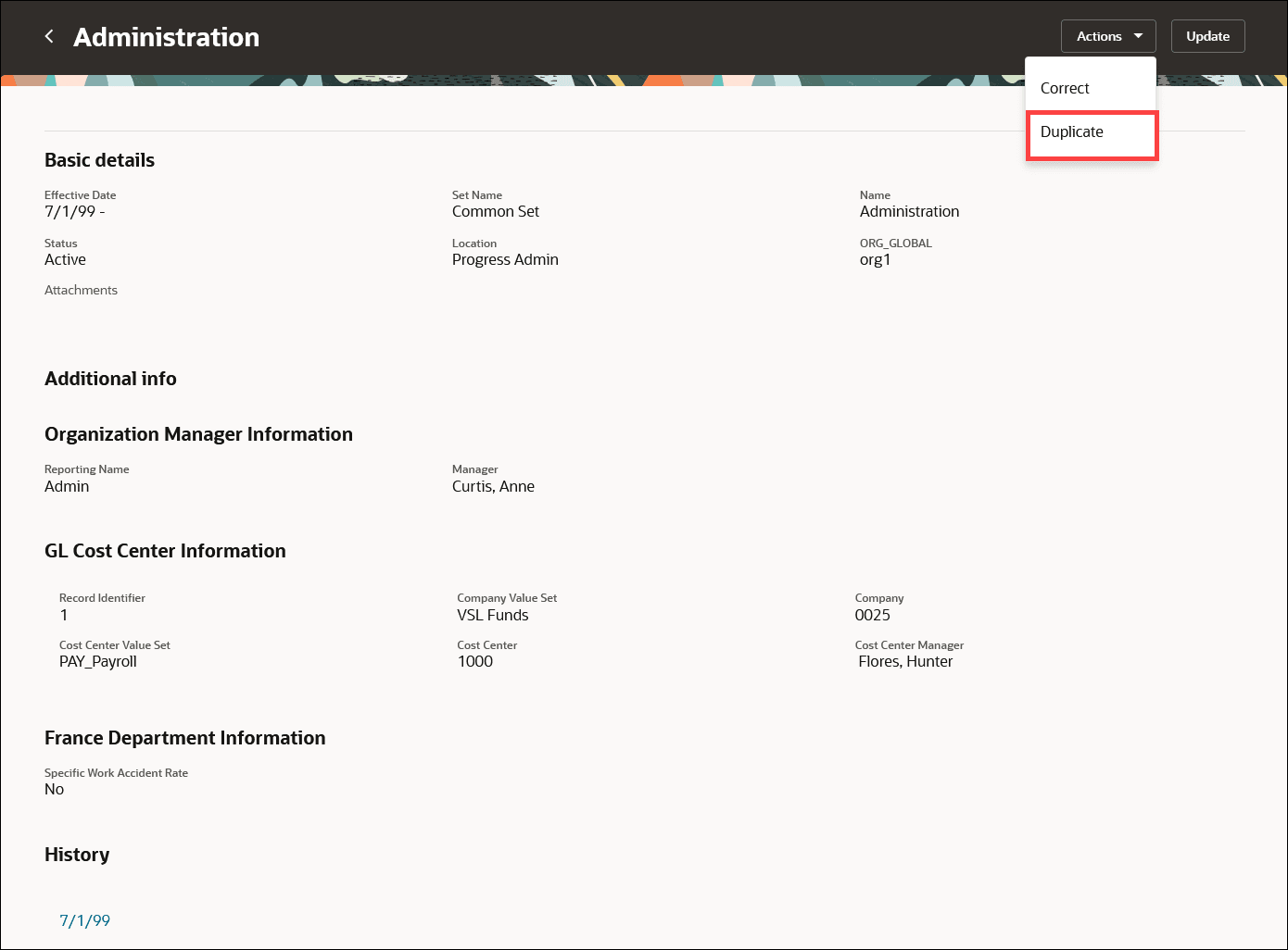

You can duplicate an existing department. On the Departments search page, search for and click the department that you want to duplicate. Click the Duplicate option in the Actions drop-down menu on the read-only department page.
Department Read-Only Page with Duplicate Action

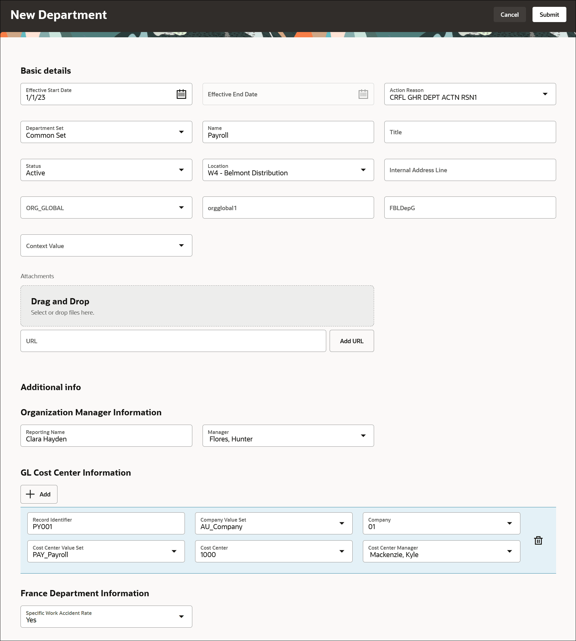

A New Department page is displayed, with the status, department set, and location already copied from the existing department. The title, action reason, name, and attachments aren’t copied. Enter the other details as required and click Submit to create the duplicate department.
Duplicate Department Showing Copied Fields
