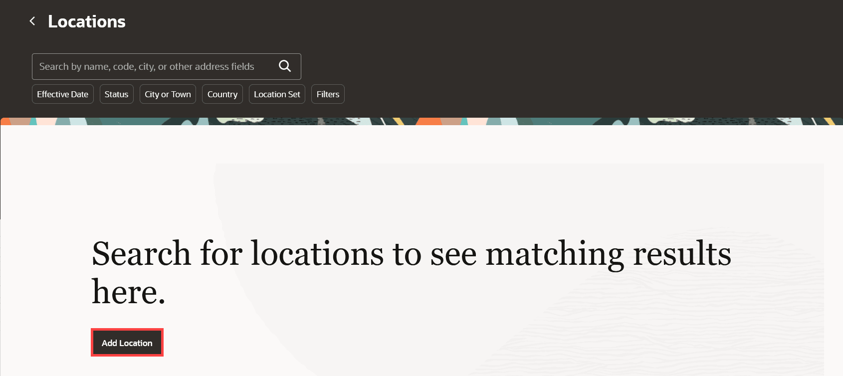

On the Locations search page, click the Add Location button.
Locations Search Page

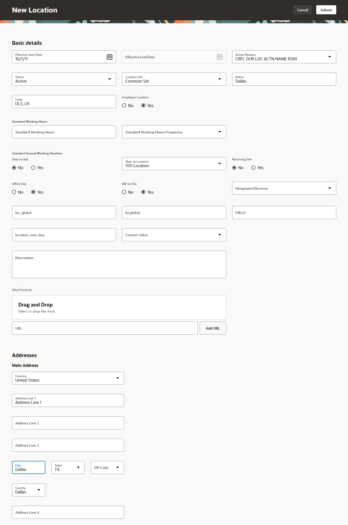

On the New Location page, enter the details as required and click Submit to create a new location.
New Location Page

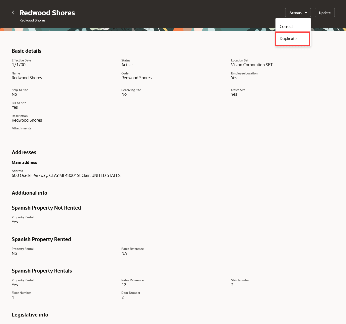

You can duplicate an existing location. On the Locations search page, search for and click the location that you want to duplicate. Click the Duplicate option in the Actions drop-down menu on the read-only location page.
Location Read-Only Page with Duplicate Action

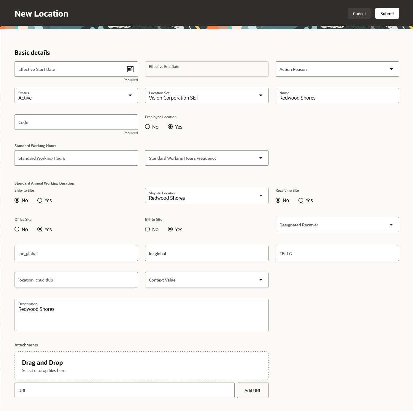

A New Location page is displayed. The location set, additional info, and legislative info are copied from the existing location to the new one. The action reason, name, and attachments aren’t copied. Enter the other details as required and click Submit to create the duplicate location.
Duplicate Location Page Showing Copied Fields

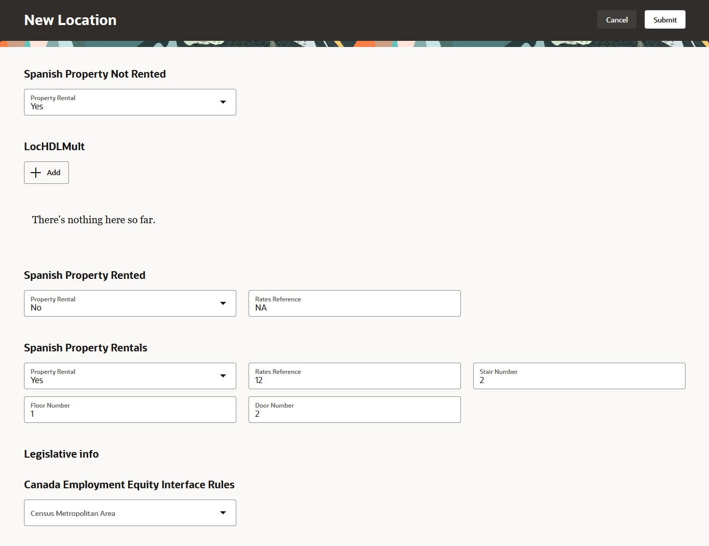

Duplicate Location Page Showing Copied Fields for Additional Info
