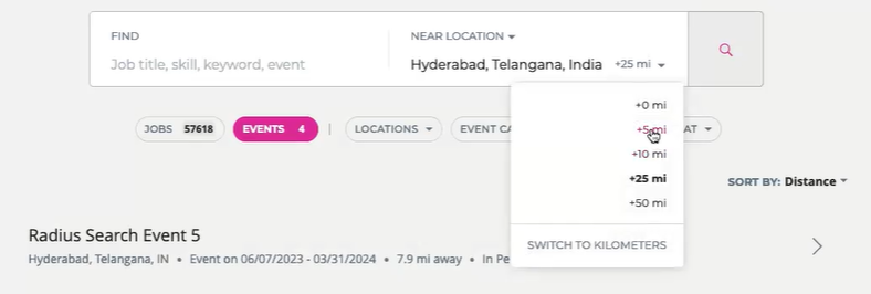

Take advantage of the new Hiring Events search enhancements that work similarly to jobs search. This includes support for:
  • My location search
  • Postal code search
  • Distance calculation
  • Radius search (supported for all location search modes)
Hiring Events Search
With these enhancements, candidates can better find the hiring events they want to attend.
