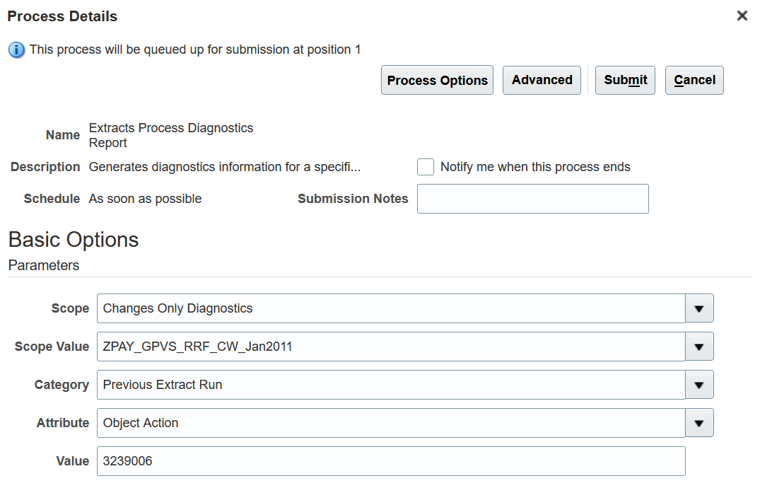

  4. In the Process Details dialog box, under the Basic Options section, select:
    • Scope of the process as Changes Only Diagnostics
    • Scope value as extract instance name
    • Mode category as one of the following:
      • Previous Extract Run: It is used for basic Changes Only extracts with parameter CHANGES_ONLY = Y
      • Object Extracted But Not Expected: It is used for advanced Changes Only extracts with parameter CHANGES_ONLY= ATTRIBUTE, ATTRIB_OLD, BLOCK_OLD, or BLOCK
    • Attribute as Object Action
    • Values as Object Action ID number
    • Screen capture of the Changes Only Extracts Diagnostics Process with its Basic Options parameters
