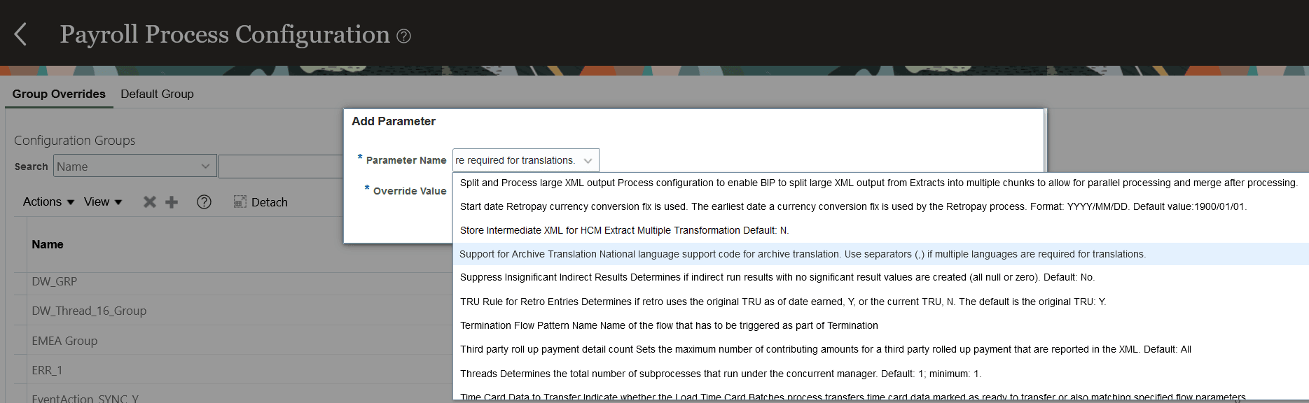

Follow these steps to add the translation parameter and set the NLS Codes as Override Values:
- Navigate to My Client Groups > Show More > Payroll > Payroll Process Configuration.
- Search for the default configuration group or click Add and create a configuration group.
- Click the Add icon and add the Support for Archive Translation National Language Support Code for archive translation parameter to the group.
- In the Override Value field, enter the NLS codes for the additional languages you require other than the application default language. Use separators if you enter multiple languages.
