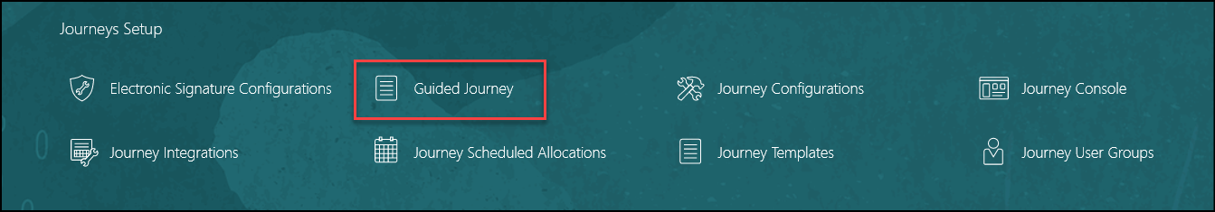

You can now configure guided journeys directly by using the new Guided Journey quick action in the Journeys Setup area under the My Client Groups tab. This quick action is available for HR professionals.
Quick Action to Configure Guided Journey

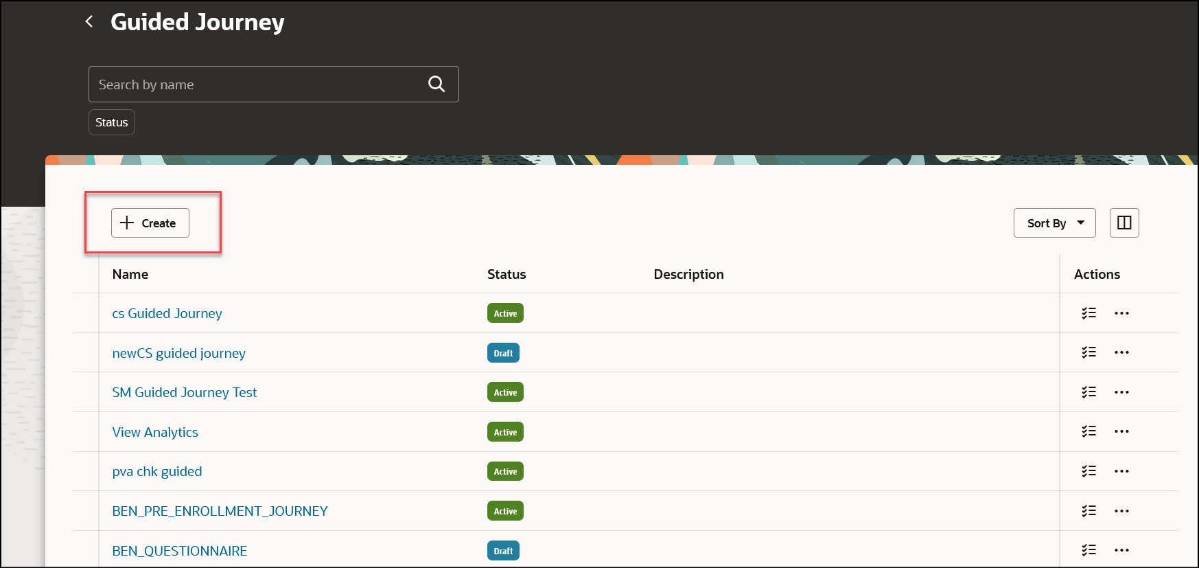

Create a Guided Journey
Options to Create Guided Journey

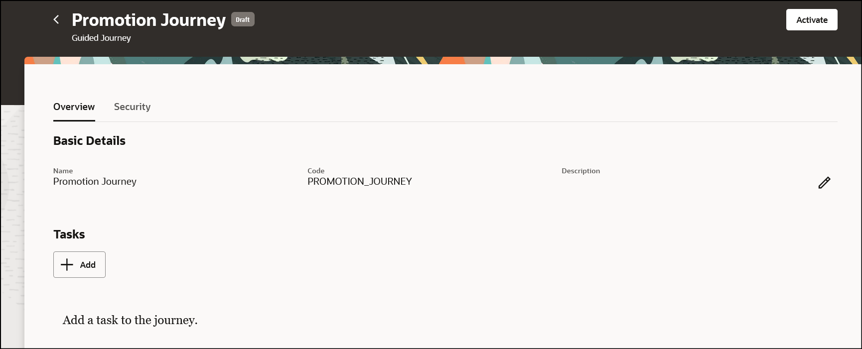

Details of the Created Guided Journey

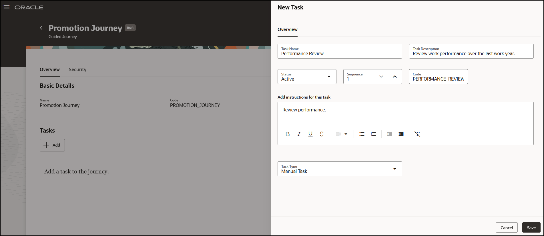

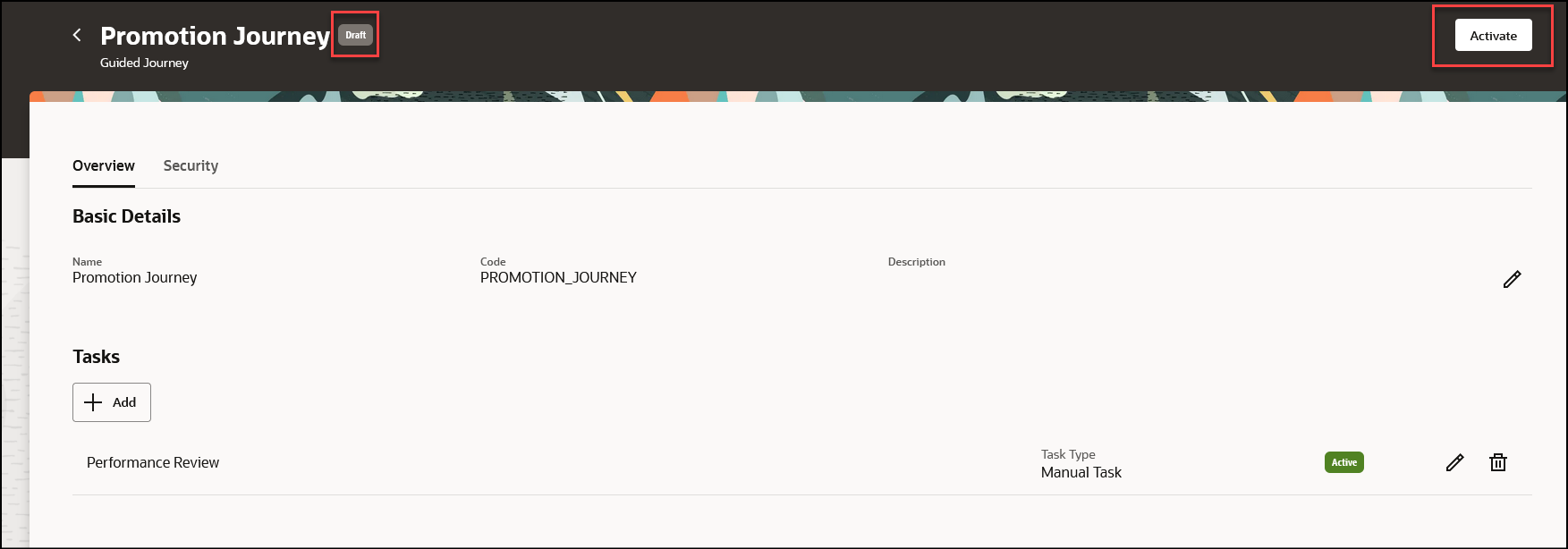

Create a Task in the Guided Journey

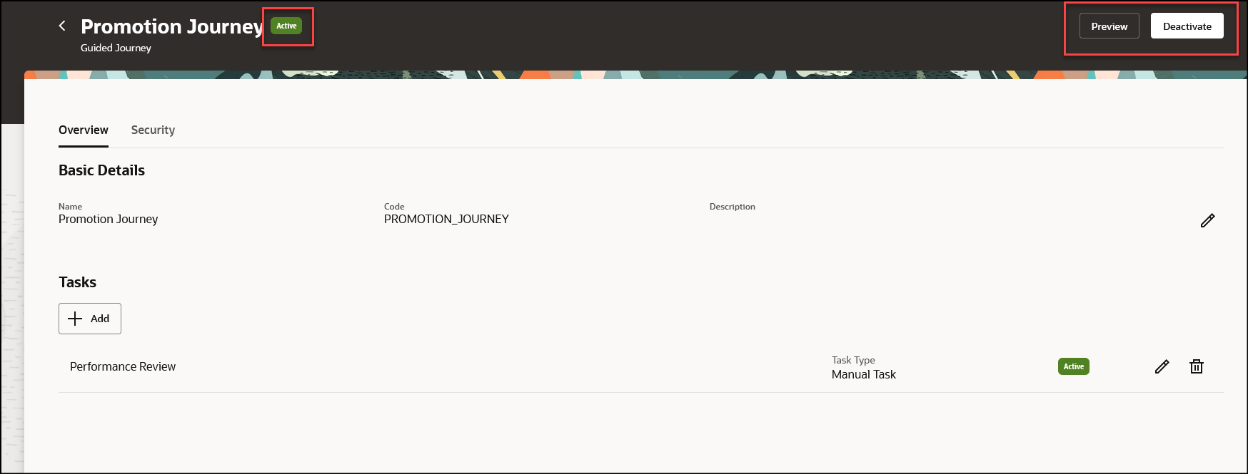

Activate the Guided Journey Containing the Created Task
Journey Status Changed from Draft to Active
Guided Journey Status Changed from Draft to Active

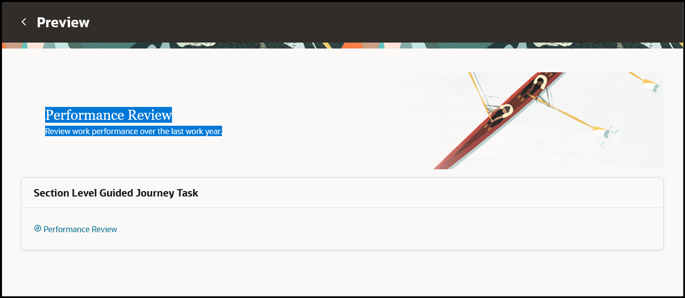

Preview the Guided Journey UI

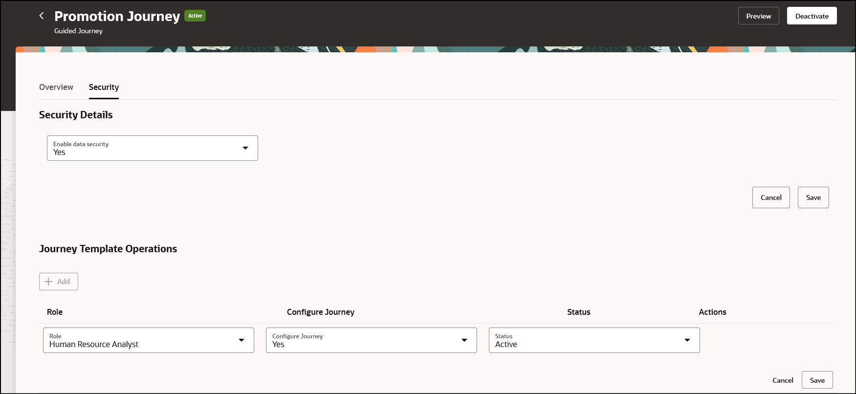

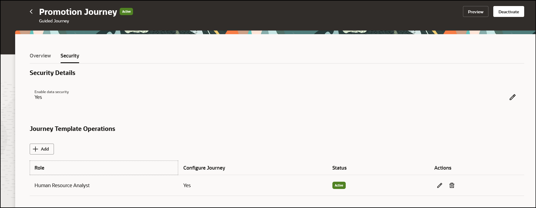

Configure Security for Guided Journey
Data Security Enabled and Role Configured for Guided Journey
