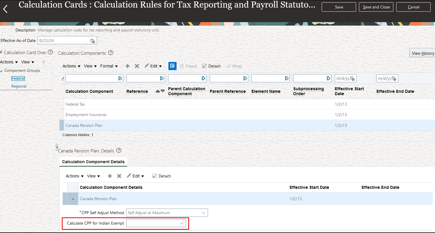

Ability to Stop CPP/QPP Deductions on Indian Exempt Wages
Currently, CPP and QPP taxes are withheld even if the payroll assignment is designated as Indian exempt. We have introduced options that can stop those deductions from occurring at the Payroll Statutory Unit (PSU) and Tax Reporting Unit (TRU) levels. Note that any settings at the TRU levels supersede the setting at the PSU level. Use the new fields below at either the PSU and/or TRU levels to designate whether CPP/QPP is calculated or not for Indian exempt wages. The default behavior (value is blank) is to have CPP/QPP deducted on the Indian exempt earnings.
Indian Exempt Field Locations
This illustration shows the new Calculate CPP for Indian Exempt field at the PSU level.
Calculate CPP for Indian Exempt Field

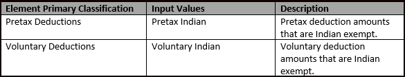

Additionally, the following new input values were created and are populated for Pretax and Voluntary deduction user-defined elements. When payroll is processed for a person designated as Indian Exempt Status, these new input values are populated with the value of the deduction amounts. If required, use the input values to create balance feeds for year-end reporting.
Note: These input values only appear for elements created from 24D onward.
Pretax and Voluntary Deductions Input Values

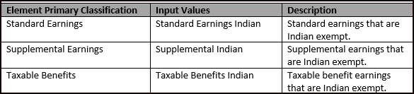

You can now use the following existing earnings elements input values for Indian Exempt year-end reporting, if required.
Earnings Elements Input Values

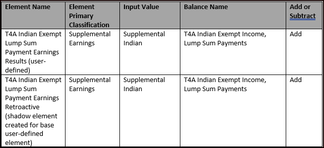

Example 2: Balance Feed to "T4A Code 148 - Indian Exempt Income, Lump Sum Payments"
In this example, the feed is required from a supplemental earnings element to report Indian Exempt wages in the T4A, Code 148.
Note: You must use the Results element.
Example 2 Balance Feeds

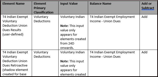

Example 3: Balance Feed to “T4 Code 95 - Indian Exempt Employment Income - Union Dues”
In this example, the feed is required from a voluntary deduction element to report the union dues related to Indian Exempt income in the T4, Code 95 (note this is a new code introduced for year-end 2024).
Note: You must use the Results element. This input value is populated only if the voluntary deduction element is processed at the assignment level.
Example 3 Balance Feeds
