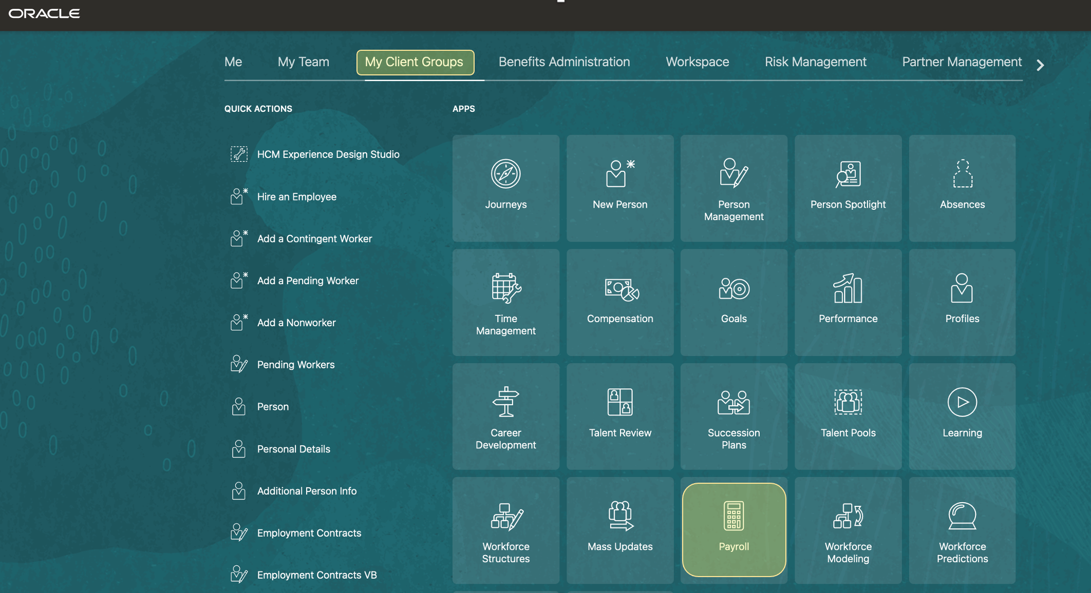

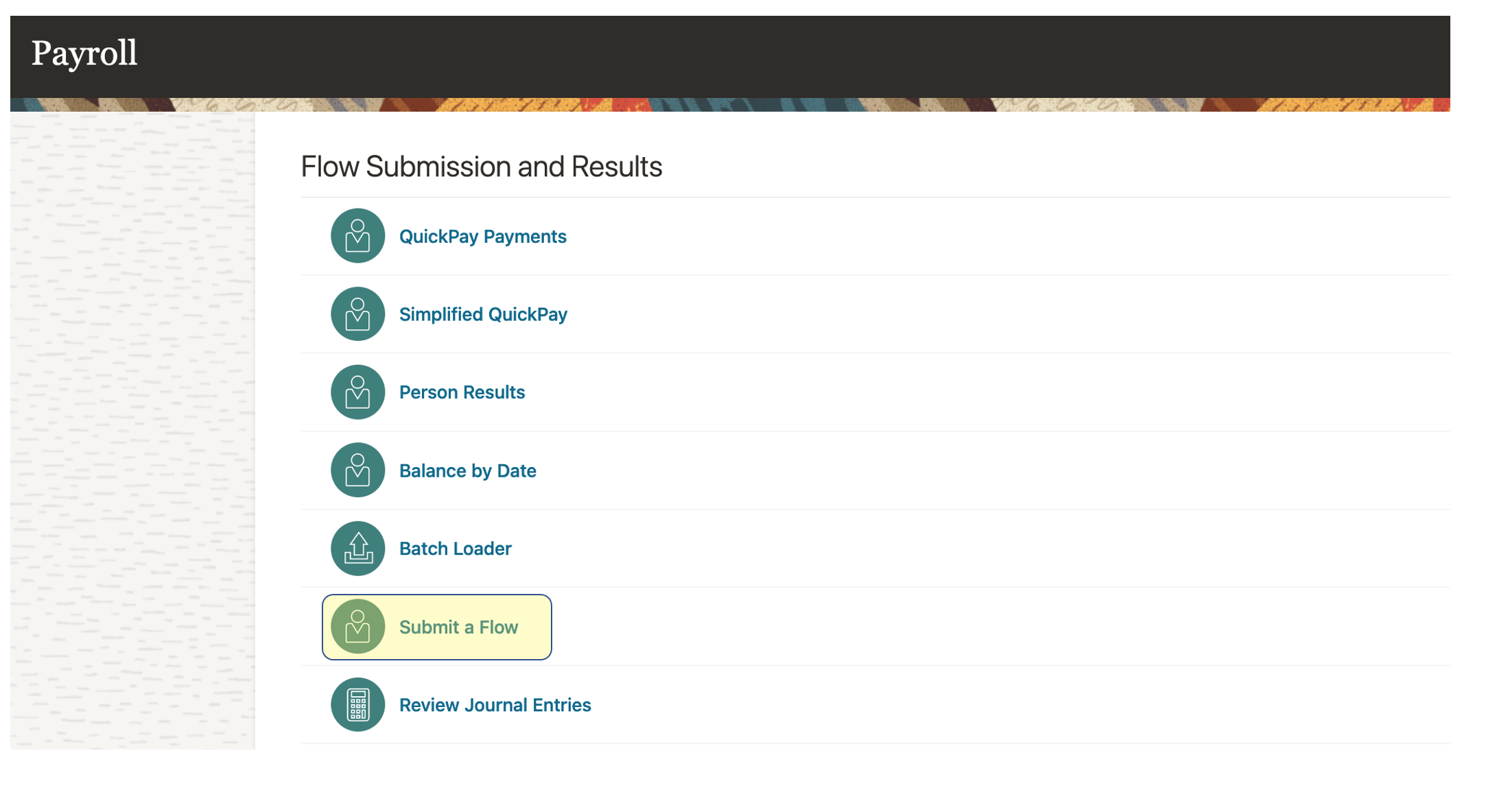

  1. On the My Client Groups > Payroll Flow page, click Submit a Flow.
My Client Groups > Payroll Work Area Tile
Payroll Work Area with the Submit a Flow Task Highlighted

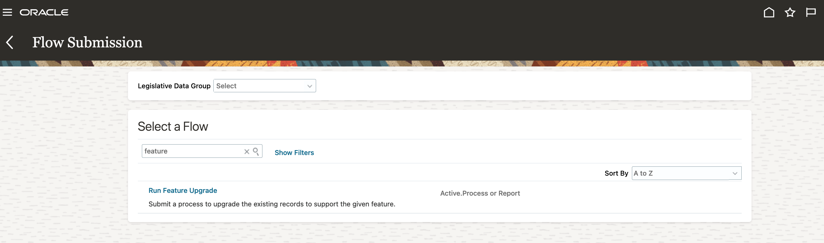

  1. On the Flow Submission page, search for and click Run Feature Upgrade.
Flow Submission Page

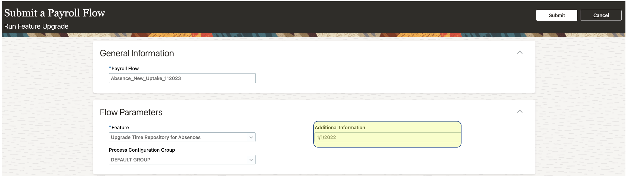

  1. On the Submit a Payroll Flow page, complete the fields as shown here:
Field Value
Payroll Flow
Enter a name, such as Migrate absence data to a new data model.
Feature
Select a group to control error logging and multithreading of the process.
For more information on the Process Configuration Group, see the Payroll Process Configuration Groups section of the Payroll Processing Rules chapter of the Implementing Global Payroll guide.
Additional Information
Enter the migration cut-off date in the dd/mm/yyyy format.
The migration process uses this date to identify the existing absences that it would upgrade to the new architecture. All the future absences and absences that overlap the start of the schedule period containing the migration cut-off date will be migrated.
If you leave the migration cut-off date blank, the migration process will migrate all absences with dates from the submission date back 3 months.
If anyone tries to change absence entries before the migration cut-off date, they get a validation error like this:
The time card or absences can't be submitted. (HXT-1665190) While the enhanced Absence Management and Time and Labor integration is enabled, absence data hasn't been migrated. Here are the specific errors and relevant absence details: TrgId: 300100563343280, StartTime: 2023-02-16 00:00:00.0, StopTime: 2023-02-16 23:59:59.999, AbsenceEntryId: 300100563343275, AbsenceTypeId: 300100031787011.
Submit a Payroll Flow, Run Feature Upgrade Page

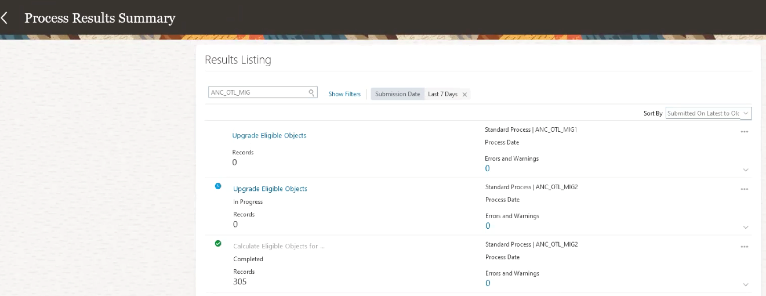

  1. Click Submit. These are the processes that run:
  • Calculate Eligible Objects for Upgrade: This process calculates all of the eligible employee records that the Upgrade Eligible Objects process will upgrade.

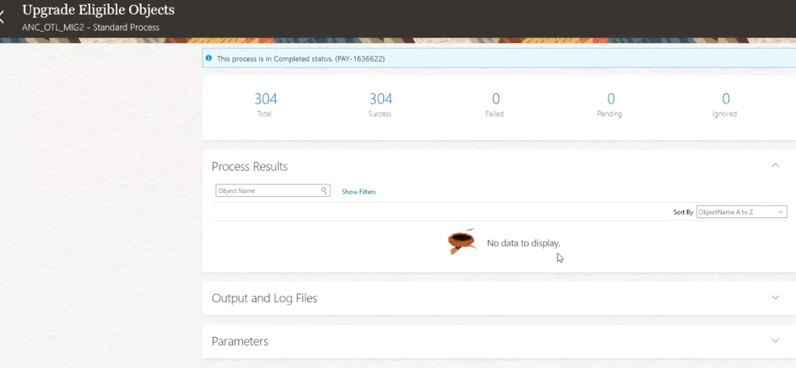

  • Upgrade Eligible Objects: This process does the actual data upgrade task.
Process Results Summary
After the processes complete, you can click the process name to view a summary of the changes. To view the logs and debugging messages, expand the Output and Log Files section.
Upgrade Eligibile Objects
