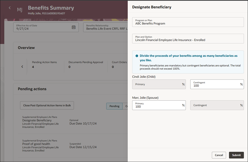

Explore the new beneficiary and dependent designation page within the Benefits Summary page, recreated in the Redwood Toolset’s Visual Builder Studio. This feature introduces enhanced functionality to streamline benefits administration tasks, delivering an improved and more intuitive experience.
To launch the Benefits Summary page, click My Client Groups, Benefits, Benefits Summary.
Beneficiary Designation Page

Here are the differences between the Designate Dependents and Beneficiaries page in the responsive Benefits Summary page and the Redwood Benefits Summary page:
Differences Between Responsive Benefits Summary Page and the Redwood Benefits Summary Page
Aspect Responsive Benefits Summary Page Redwood Benefits Summary Page
Contacts that are added after the life event is processed will be picked up as eligible dependents to allow participants to designate them.
Not supported.
Supported if these conditions are met:
  • Allow new contacts to be added as eligible dependents option in self-service configuration is selected.
  • No family member rule exists for any of the plans in the setup.
  • Contact start date is before the life event occurred date.
Contacts that are added after the life event is processed will be picked up as eligible beneficiaries to allow participants to designate them.
Not supported.
When the contact creation date is after the life event occurred date and the contact start date is before the life event occurred date, then such contacts also can be designated.
