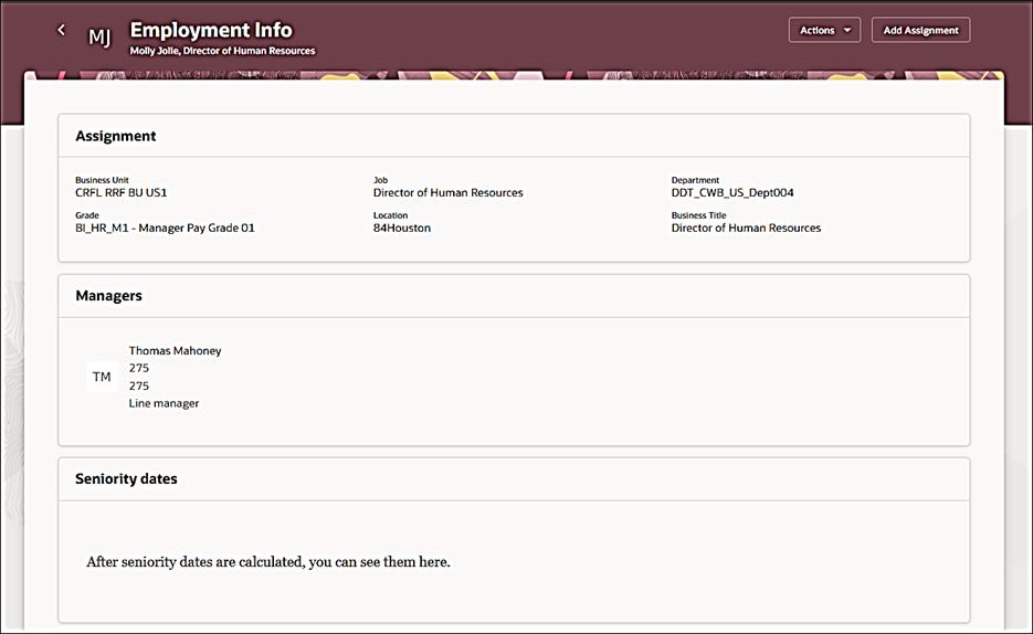

Explore the new employment page within benefits summary, recreated in the Redwood Toolset’s Visual Builder Studio to improve the benefits administrator experience by providing the same consistent functionality across Redwood pages.
To launch the Benefits Summary page, click My Client Groups, Benefits, Benefits Summary.
You can navigate to the Employment Info page from the Actions menu in the Benefits Summary page.
Employment Info Page
This feature lets you experience Redwood’s high-fidelity interactions.
