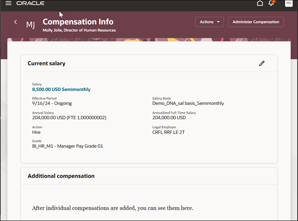

Explore the new compensation page within the Benefits Summary page, recreated in the Redwood Toolset’s Visual Builder Studio. This feature introduces enhanced functionality to streamline benefits administration tasks, delivering an improved and more intuitive experience.
To launch the Benefits Summary page, click My Client Groups, Benefits, Benefits Summary.
You navigate to the Compensation Info page from the Actions menu in the Benefits Summary page.
Compensation Info Page
This feature lets you experience Redwood’s high-fidelity interactions.
