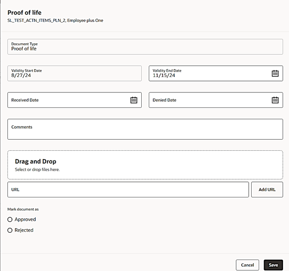

Here are the differences between the certification page in the responsive Benefits Summary page and the Redwood Benefits Summary page:
Differences Between Responsive Benefits Summary Page and the Redwood Benefits Summary Page
Aspect Responsive Benefits Summary Page Redwood Benefits Summary Page
Single flow for uploading, approving, rejecting, or closing the certification action items.
No Yes
Even if the document upload is configured in the setup page, you can enter the received date without uploading document.
Allowed Not allowed. Document must be uploaded.
Approve a document and enter denied date instead of the received date.
Allowed
Not allowed. If the document is approved, administrator can enter only the received date. Once the received date is populated, uploading of document isn’t allowed.
Reject a document and enter received date instead of the denied date.
Allowed
Not allowed. If the document is rejected, administrator can enter only the denied date. A rejected document gets delinked from the certification action item.
Validation criteria for the election date against the received date.
The received date must be greater than the election date.
The validation criteria remain the same as in the responsive Benefits Summary page. But the validation happens only for the action items that don’t cause suspension.
Here are some points to remember:
You can’t edit an approved document. Based on the validity period of the document, they will be linked to new certification requirements. For certifications that don’t require documents, only the Received Date or Denied Date should be entered.
