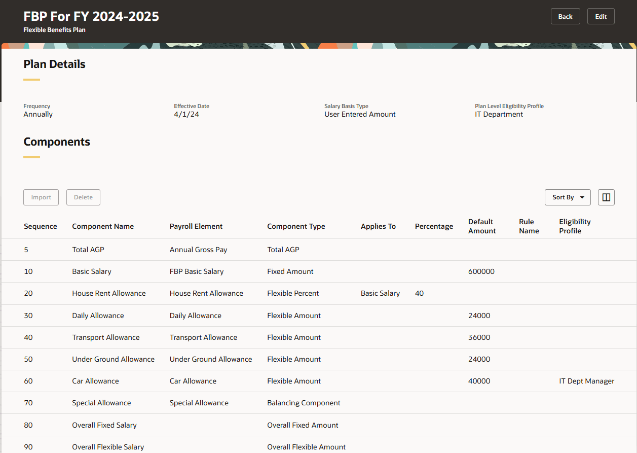

Flexible Benefits Plan - Payroll Administrator View
From the home page, navigate to Setup and Maintenance > Legal Entity Calculation Card > Flexible Benefits Plan to view the Flexible Benefits Plan in administrator view.
The payroll administrator can set up the following:
- Set up different flexible benefit plans with pay components, which cater to different departments and employee categories.
- Define the payroll elements
- Set up the eligibility profiles and rules for the plan.
- Set up the timelines during which employees are allowed to modify their flexible benefit plan.

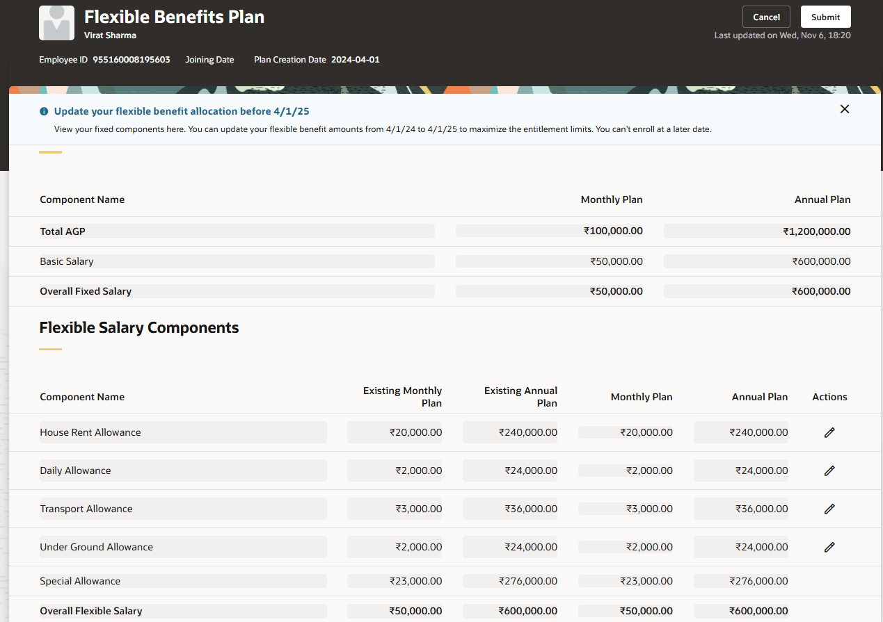

Flexible Benefits Plan - Employee View
To view the flexible benefits plan in employee self-service, from the home page, navigate to Me > Flexible Benefits Plan.
The employees can set up their flexible benefits plan during the time period allowed, by modifying the flexible salary components according to their needs.
