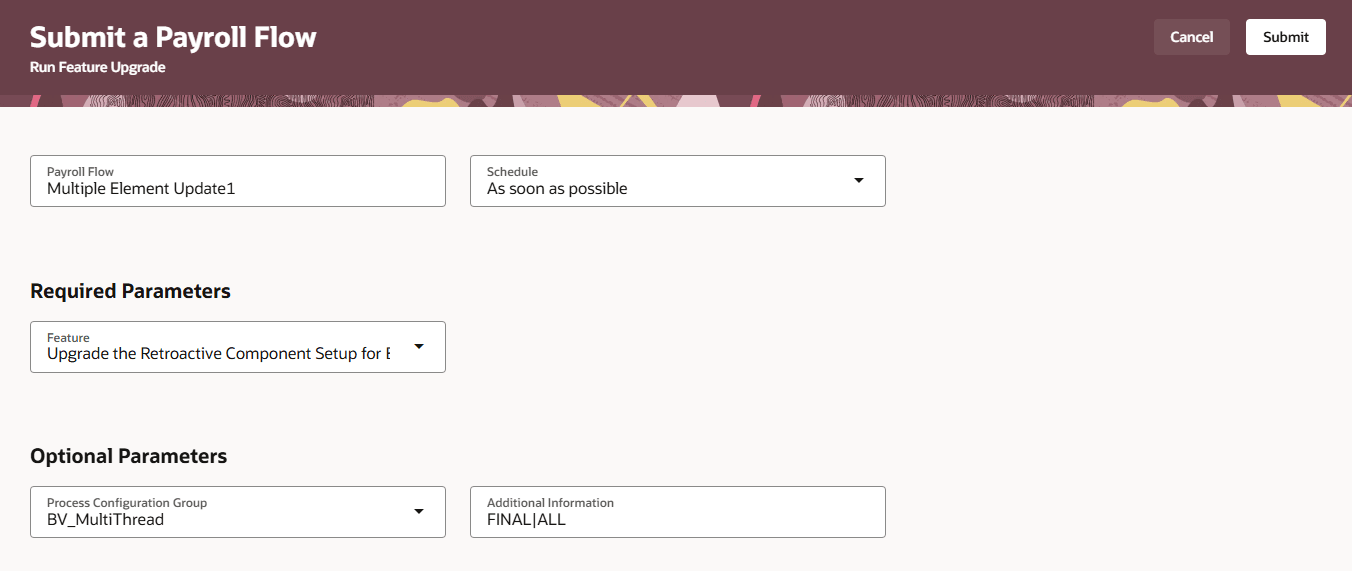

Run the feature upgrade flow using one of the options for updating existing elements.
  1. Navigate to My Client Groups > Payroll > Submit a Flow and select the Run Feature Upgrade payroll flow
  2. In the Feature, select the Upgrade the Retroactive Component Setup for Elements in India Payroll.
  3. In the Optional Parameters, select a Process Configuration Group.
  4. In the Additional Information field, select the type of mode to run the flow and click Submit.
  • Use DRAFT mode to list all the retroactive elements that will be updated when you run this flow.
  • Use FINAL mode to modify the setup for a single element and verify the update process. Enter ‘FINAL|’ followed by the base element name.
    Example: ‘FINAL|Basic’ where Basic is the base element name created from the earnings template.
  • Use FINAL mode to modify the setup for all elements created with the Retro active setup enabled.
    Example: ‘FINAL|All’
