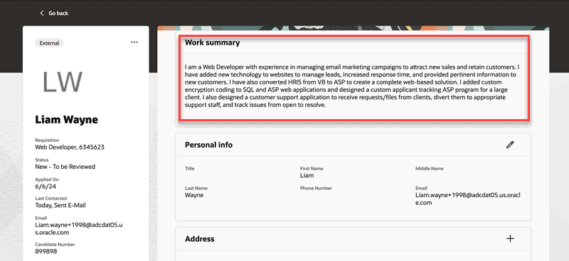

From this upgrade onwards, when Redwood is enabled, and the candidate uses Recruiting Assistant to generate the work summary, you can see it displayed on the Details tab of the job application page, as shown here.
Work Summary on the Job Applications Details page in Redwood
Note: When Redwood isn’t enabled, the work summary is still stored as a cover letter in the attachments section of the job application. If you’re switching to Redwood from this upgrade onwards, previously created work summaries will continue to be displayed as attachments in the job application details page.
This feature displays the work summary prominently on the job application page, providing a quick snapshot of the candidate’s skills and abilities.
