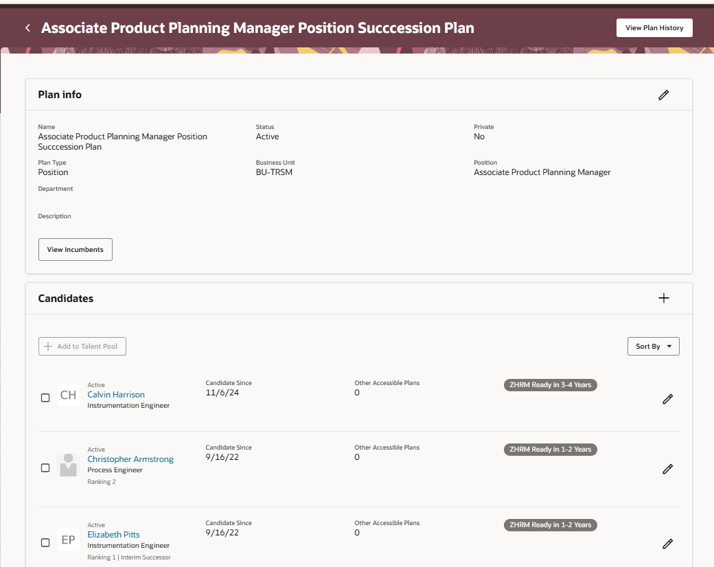

Candidate List Before the Candidate’s Employment is Terminated

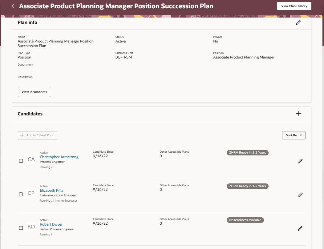

Candidate List After the Candidate’s Employment is Terminated

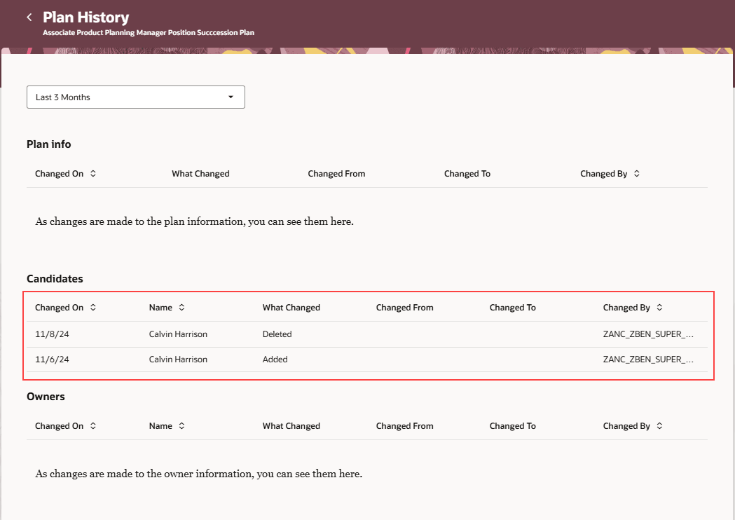

When you view the plan history, you can see that the candidate whose employment has been terminated is removed from the plan.
Candidate Whose Employment Is Terminated Is Removed

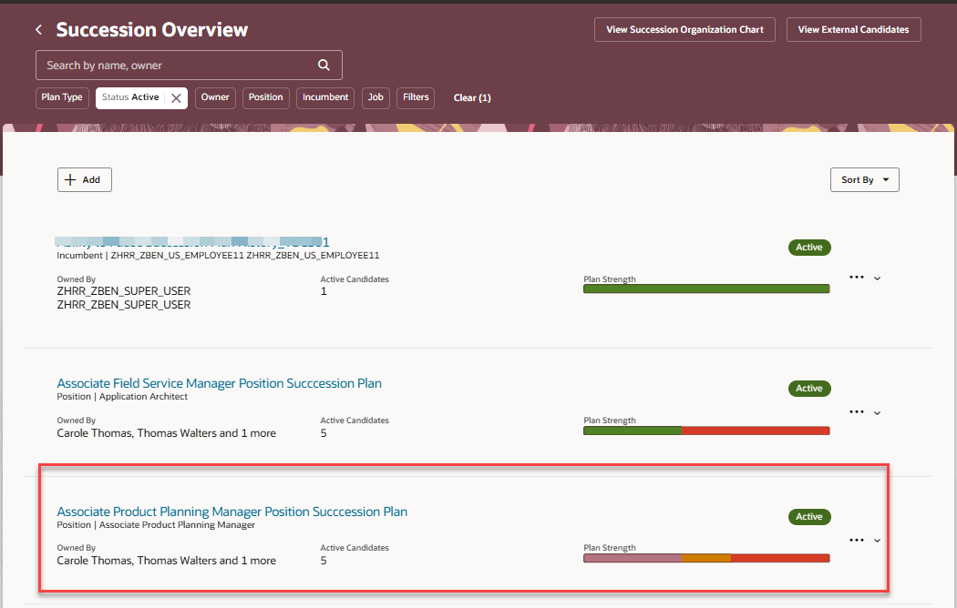

The active candidates count and plan strength indicator for the succession plan on the Succession Overview page is also updated.
Plan Summary Before Removal of Candidate Whose Employment is Terminated

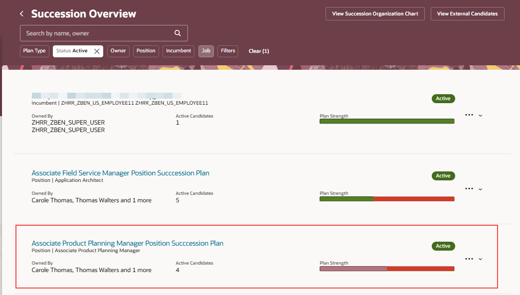

Plan Summary After Removal of Candidate Whose Employment is Terminated
