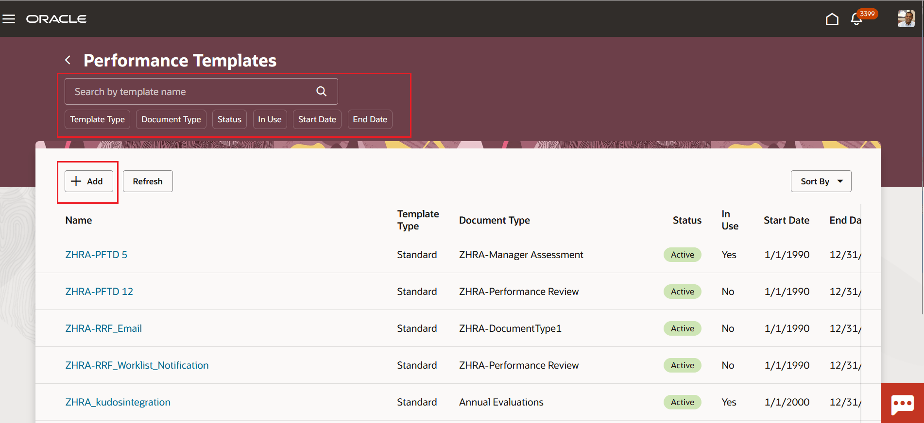

As a HR user, you can go to My Client Groups > Performance > Setup and Maintenance > Performance Templates
Screenshot that shows the Redwood Performance Templates page with the search filters and Add button highlighted.
Performance Templates Page
On the Performance Template page, you can do the following:
  • Search and select an existing performance template to edit it.
  • Create new performance templates.
  • Refresh the list of templates.
  • Delete not in use templates.

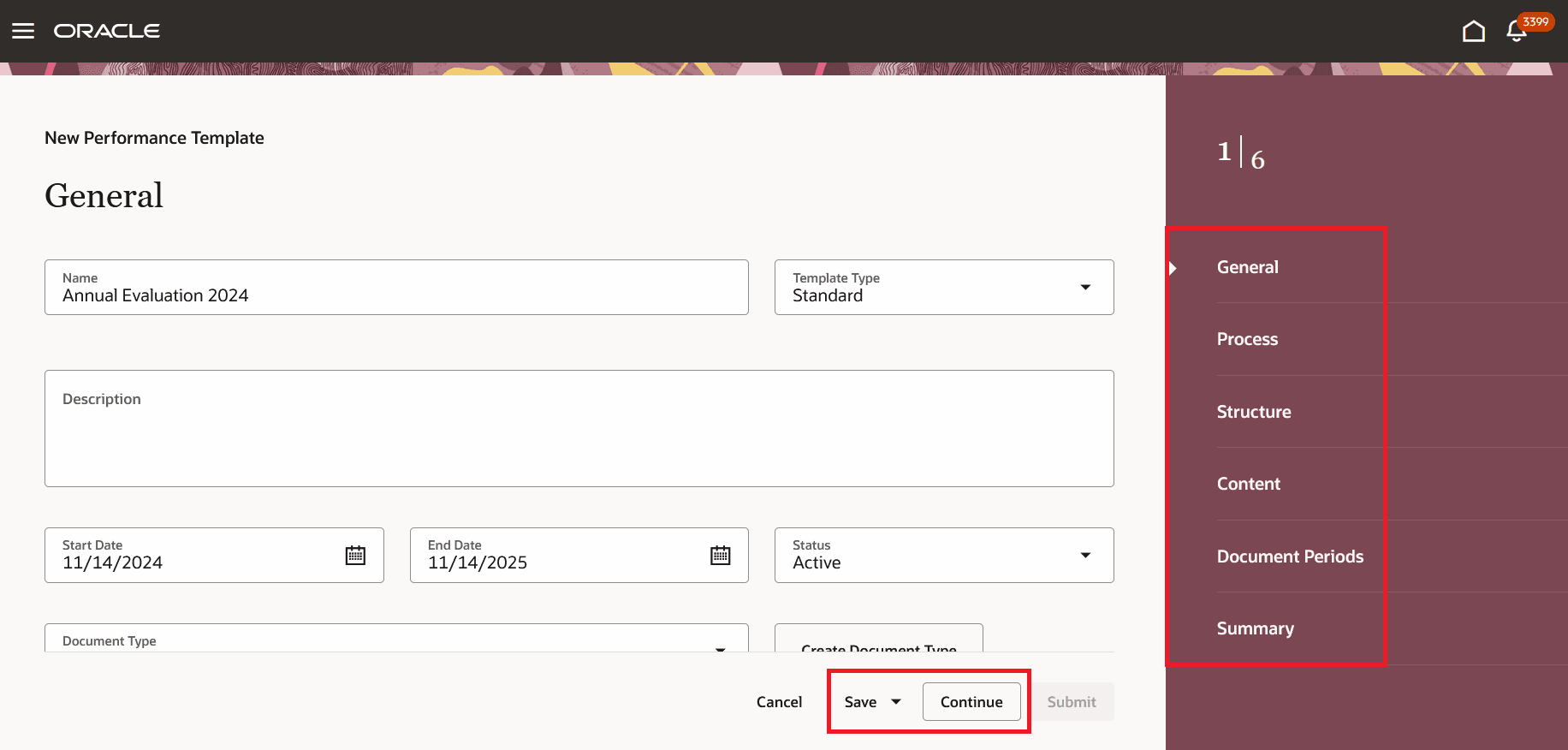

Screenshot that shows the Redwood Performance Template page with the steps and Save buttons highlighted.
Guided Process to Create New Performance Template
You can use Add to create a performance template using the guided process. Each tab of the template is now available as a separate step. You can add details as you progress through each step and Save. You can click Continue to go to the next step.

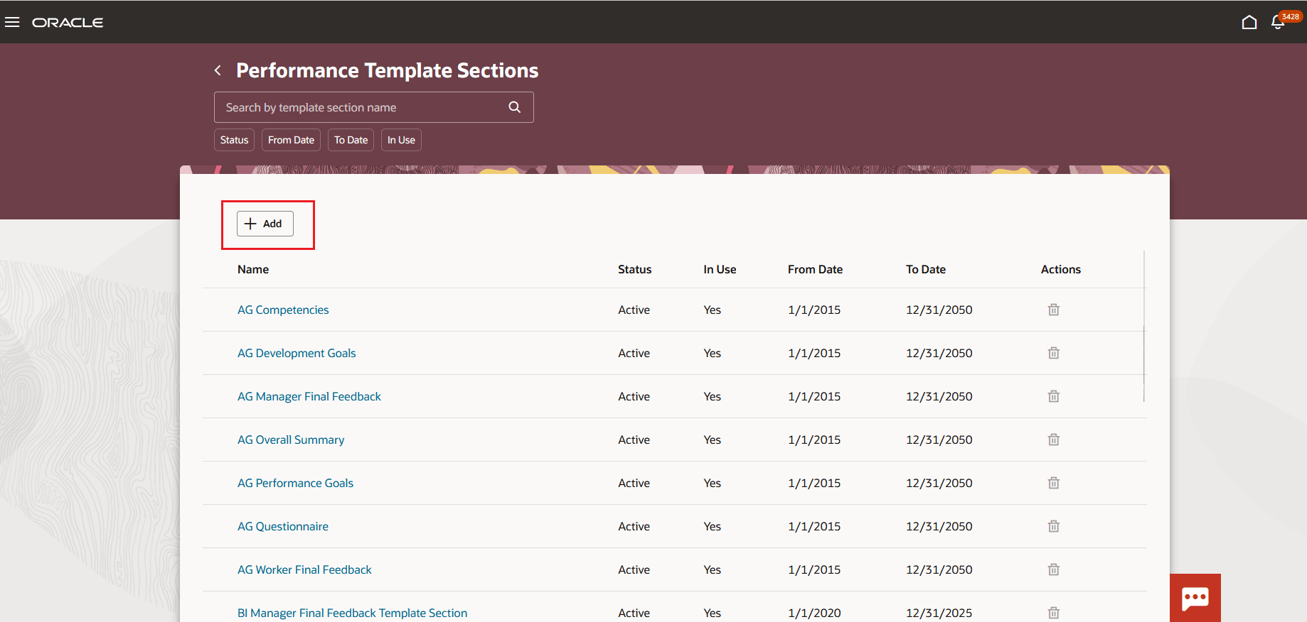

You can go to My Client Groups > Performance > Setup Maintenance > Performance Template Sections to access the Performance Template Sections page.  You can use existing template sections or create a new with the content items you require. You can delete the template sections that are not in use.
Screenshot that shows the Redwood Performance Template Sections page with the Add button highlighted.
Performance Template Sections Page

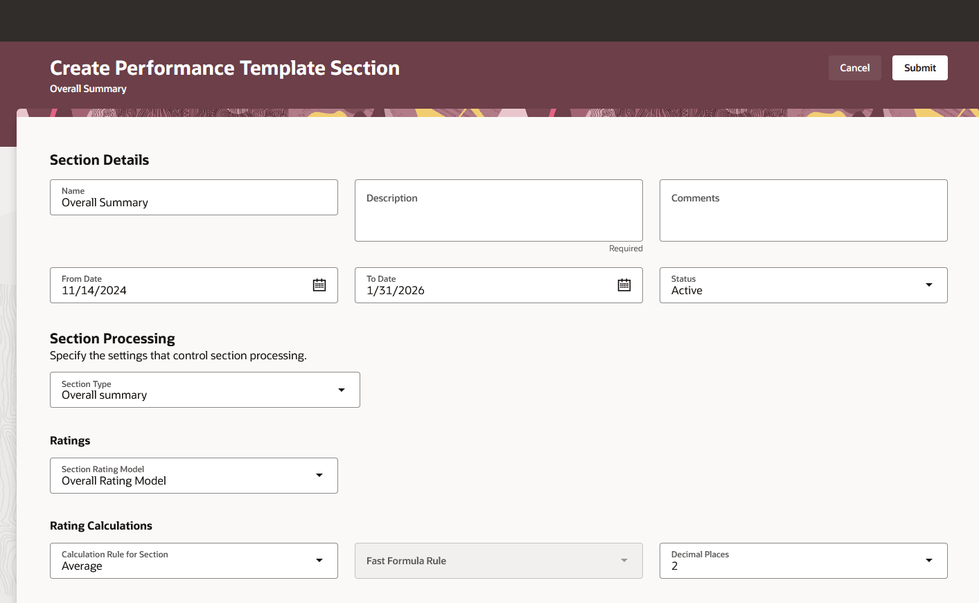

Screenshot that shows the Redwood Performance Template Sections page when creating a new template section.
New Performance Template Section
