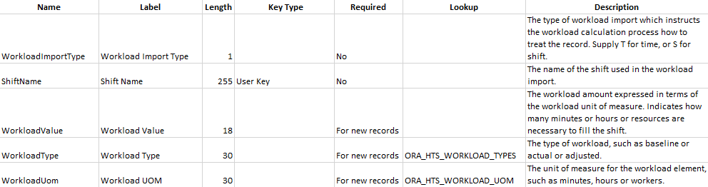

You can now use the WorkloadPlan object and HCM Data Loader to import shift-based workloads to establish the workload for scheduling. Here's how you establish a shift-based workload:
- Set Workload Import Type to S.
- Provide a shift name that matches an enterprise shift configuration, such as 8:00 AM - 5:00 PM.
- Set the workload unit of measure to Workers
- Set a count of workers to establish the workload for a shift.
The imported records act as open shifts that can get assigned to workers as part of the schedule generation process. If workers don't match the conditions, the records continue to act as open shifts.
