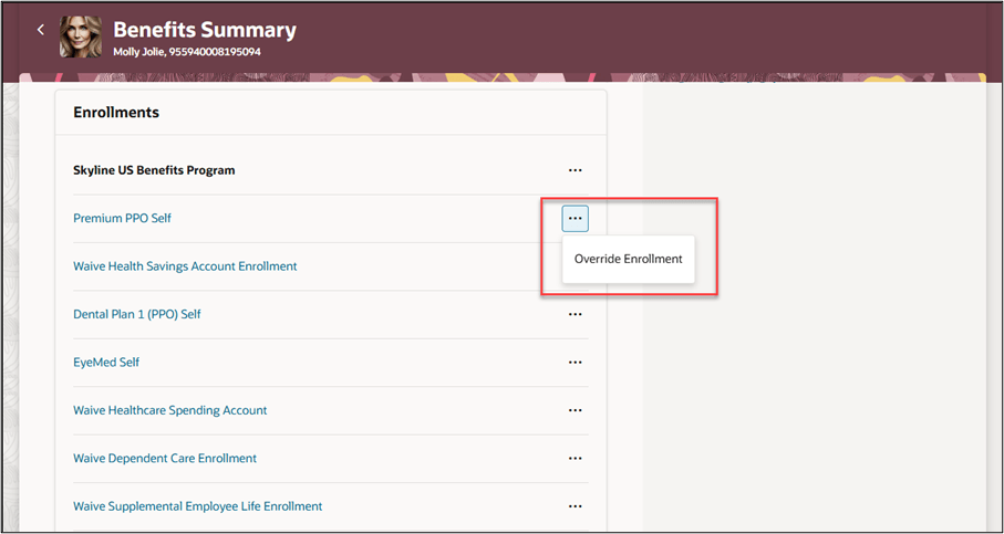

Explore the new enrollment override functionality within the benefits summary page recreated in the Redwood Toolset's Visual Builder Studio. This feature introduces enhanced functionality to streamline benefits administration tasks, delivering an improved and more intuitive experience.
To launch the page, click Benefits Administration > Benefits Activity Center. Navigate to the Benefits Summary page.
Screen capture of the Enrollment Overrides Page in Benefits Summary with the Override Enrollment button highlighted.
This feature lets you experience Redwood’s high-fidelity interactions.
