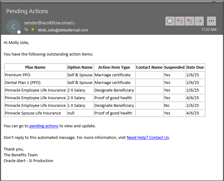

Enable Benefits Pending Actions Alert
You can now use the standard alerts functionality to send automatic notifications to benefits participants for their outstanding pending actions.
Screen capture of Benefits Pending Actions Alert email.
This enhancement reduces the need for Benefits administrators to send manual communications and thereby saves time.
