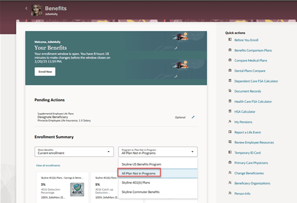

Explore the new Enhancements to the Benefits Self-Service Landing page
The pending actions region on the benefits self-service landing page will be hidden when no outstanding pending action exists.
Pending Actions Region
You can now filter the enrollment summary and enrollment details page by All Plans Not in Program.
All Plans Not in Program Filter
This enhancement lets you experience Redwood's high-fidelity interactions.
Steps to enable and configure
