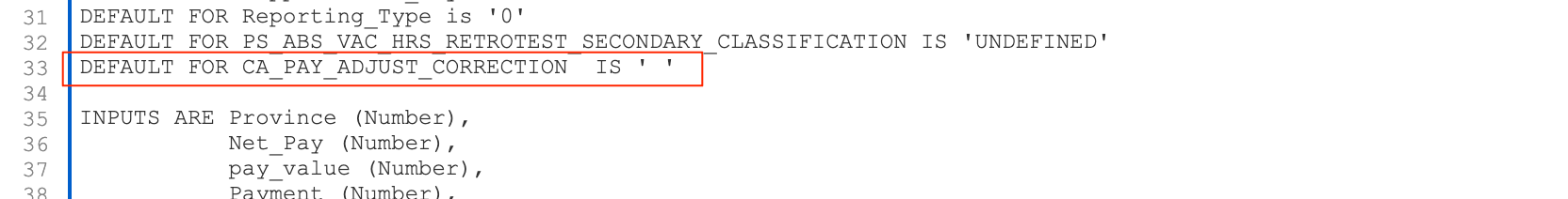

    1. Revision 1
Add
DEFAULT FOR CA_PAY_ADJUST_CORRECTION  IS ' '
Above the line
INPUTS ARE Province (Number)
Revision 1 Code Example

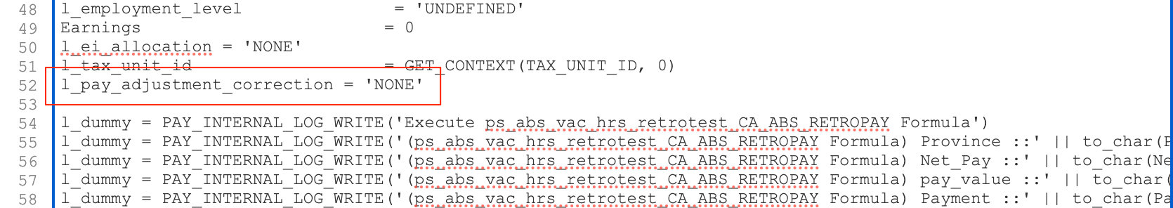

    1. Revision 2
Add
l_pay_adjustment_correction = 'NONE'
Above the line
l_dummy = PAY_INTERNAL_LOG_WRITE('Executeps_abs_vac_hrs_retrotest_CA_ABS_RETROPAY Formula')
Revision 2 Code Example

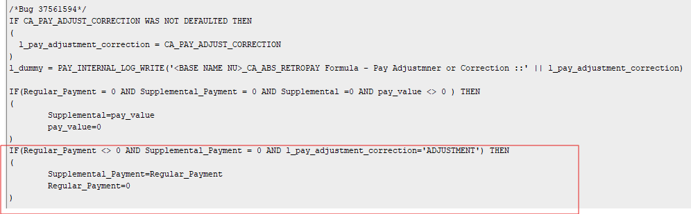

    1. Revision 3
      To tax the pay correction case with regular taxation we need to do the following changes.
      If the following code is present in the formula and it is commented out, uncomment the code and add “AND l_pay_adjustment_correction='ADJUSTMENT” condition to the IF statement below
      /*IF(Regular_Payment <> 0 AND Supplemental_Payment = 0) THEN
               Supplemental_Payment=Regular_Payment
               Regular_Payment=0
      If the commented code is not present then add the below code:
      IF(Regular_Payment <> 0 AND Supplemental_Payment = 0 AND l_pay_adjustment_correction='ADJUSTMENT') THEN
               Regular_Payment=0
      The code snippet below illustrates the formula after changes are complete.
Revision 3 Code Example
