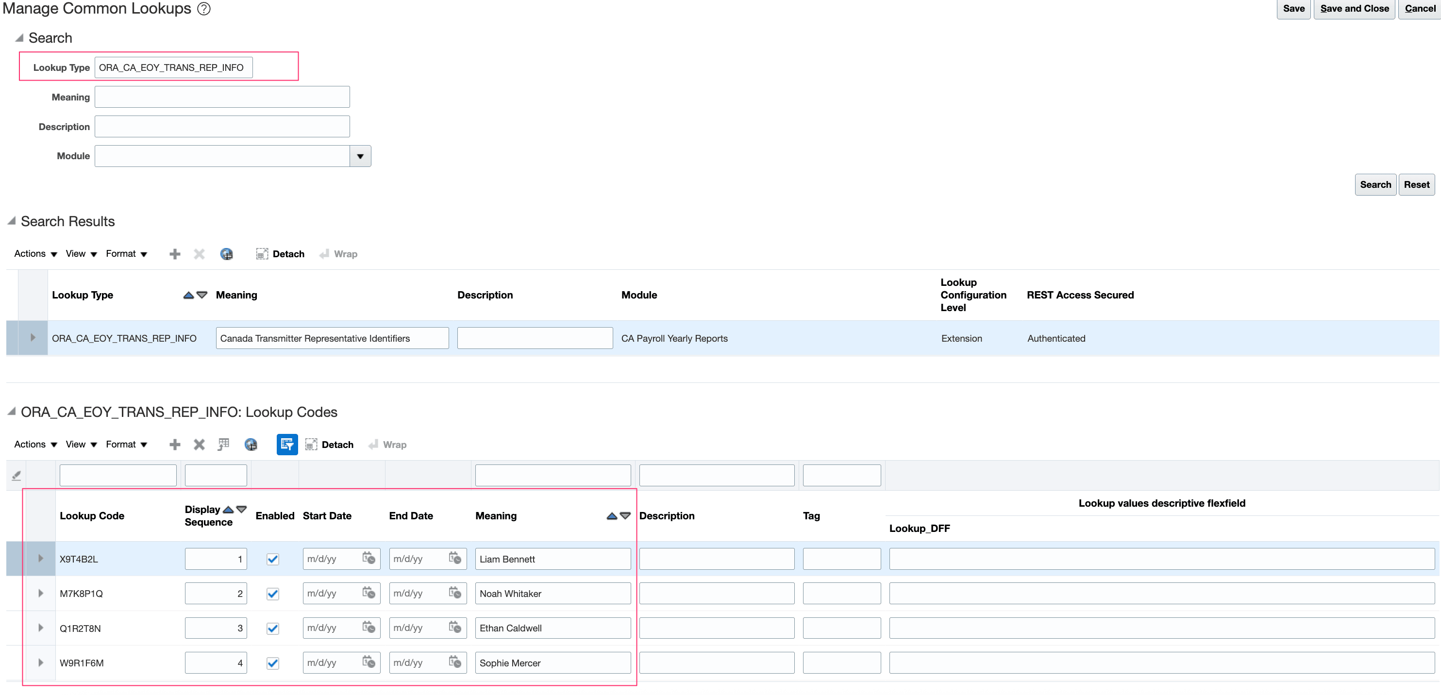

Extensible Common Lookup
The new extensible common lookup details are below. Use this lookup to add the transmitter representative identifiers that your business requires. Once configured, this list of transmitter representative IDs is available for selection in the End-of-Year Reports process.

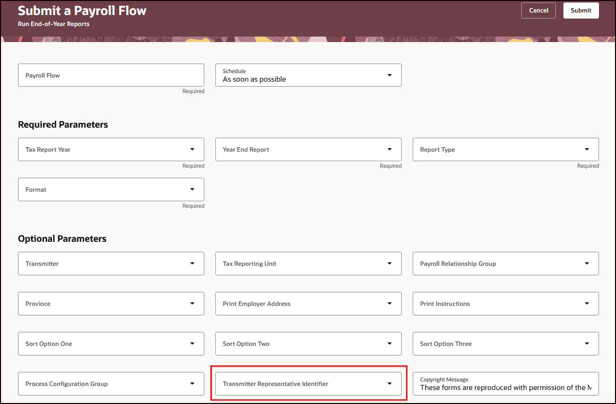

End-of-Year Reports Process Parameter
A new parameter, Transmitter Representative Identifier, was added to the End-of-Year Reports process. Use this parameter to override the default transmitter representative ID configured at the TRU. This parameter is only applicable for the T4 and T4A.
Transmitter Representative Identifier Parameter
This enhancement provides greater flexibility by supporting employers who manage year-end reporting through multiple representatives.
Steps to Enable
If required, to override the default Transmitter Representative Identifier configured at the TRU, add the transmitter representative identifiers to the new lookup using these steps:
  1. Navigate to Setup and Maintenance and select the Tasks menu.
  2. Click Search, and search for Manage Common Lookups.
  3. Search for Lookup Type = ORA_CA_EOY_TRANS_REP_INFO.
  4. Under Lookup Codes, click New and add the lookup code details:
    1. Lookup Code: Enter an alphanumeric representative identifier. This grants the representative associated with this ID access to the submitted T4 or T4A return.
    2. Display Sequence: Enter a number to specify the order of appearance in the parameter’s list of values.
    3. Enabled: Check this box to make the ID visible in the parameter’s list of values.
    4. Start and End Dates: Optionally enter start and end dates.
Note:  If specified, only records active as of December 31 of the reporting year are available for selection.
    1. Meaning: Enter the representative’s name or description.
  1. Click Save and Close.
This illustrates a sample configuration of multiple Transmitter Representative Identification.
Multiple Transmitter Representative ID Configuration
