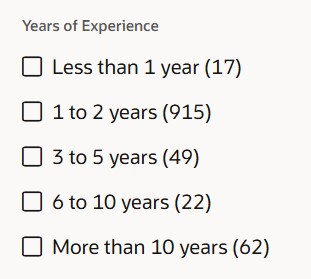

  • Years of Experience (Work Experience)
  • Citizenship (Candidate Info)
Years of Experience Filter
