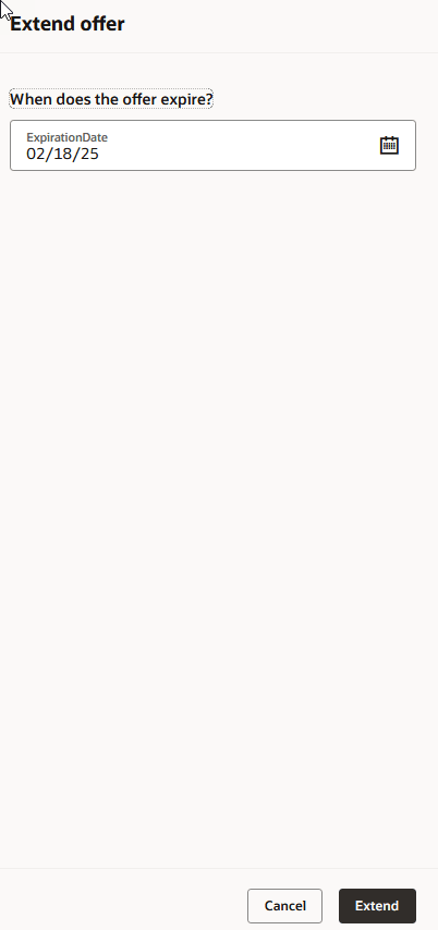

Take advantage of the Redwood Extend Offer page that has been recreated in the Redwood toolset called Visual Builder Studio (VBS).
When the Redwood profile options are enabled, upon clicking the Extend Offer action from the Redwood job applications list page, job application details page, and job offers list page, you’ll see the new Redwood Extend Offer page for extending job offers. You can now see the expiration date of the job offer while extending the offer. The expiration date is prepopulated as “system date + 7 days”. You can modify it as per your business process.
Extend Offer Page
Extend Offer Page
As the Extend Offer action is controlled by the Perform Recruiting Candidate Selection Process Offer Actions scheduled process, you’ll see a banner message until the job offer is extended to the candidate. When the job offer is extended, the phase and state of the job application will change to Offer – Extended (as in responsive UI). You'll will see similar screens and behavior when you resend the job offer.
