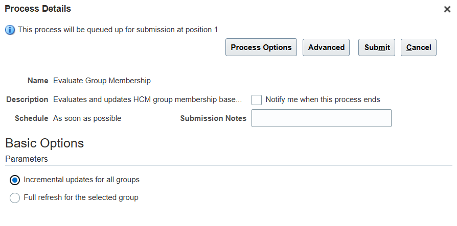

The Evaluate Group Membership process now has these two basic options:
  • Incremental updates for all groups: The process evaluates all group memberships based on assignment changes and hiring events. After creating a group and refreshing it, the incremental update considers any new event related to assignment changes or hiring and updates all memberships accordingly.
Evaluate Group Membership Process Details Page Showing the New Basic Options

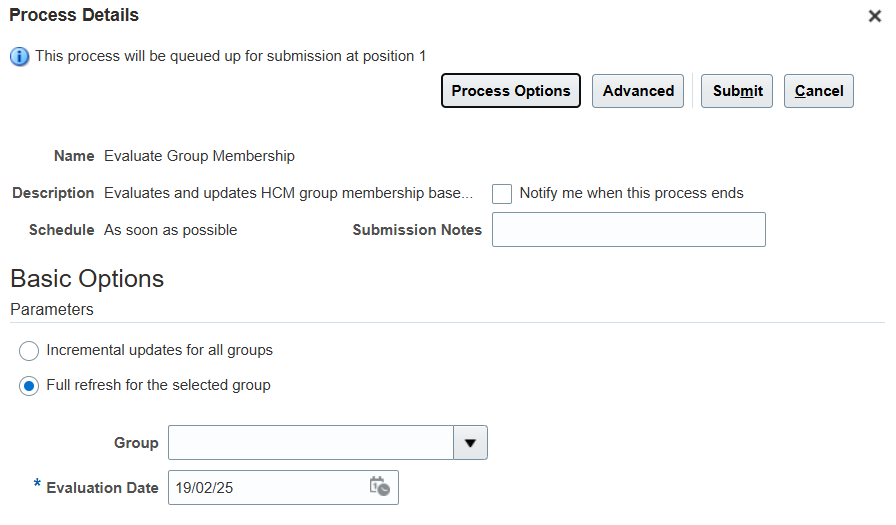

  • Full refresh for the selected group: The process evaluates the membership only for the selected group and specified date. The Group parameter isn't mandatory so that you can leave it blank to launch a full refresh for all groups. Also, you can select any evaluation date, even a past one to update a group membership according to a past change.
The evaluation process doesn’t consider any future change. You might need to refresh the group again for the current date to account for all changes and ensure all memberships are accurate as of the current date. For example, a worker belonging to the Support group moves to the Consulting group on March 3 for 2 weeks. They return to the Support group on March 17. If a full refresh launches on March 3 for the Consulting group, the membership will now include the worker. This last membership isn't end dated on March 16 at that time. The process end dates the membership when it’s launched again on March 17.
Evaluate Group Membership Process Details Page Showing the Full Refresh Fields
