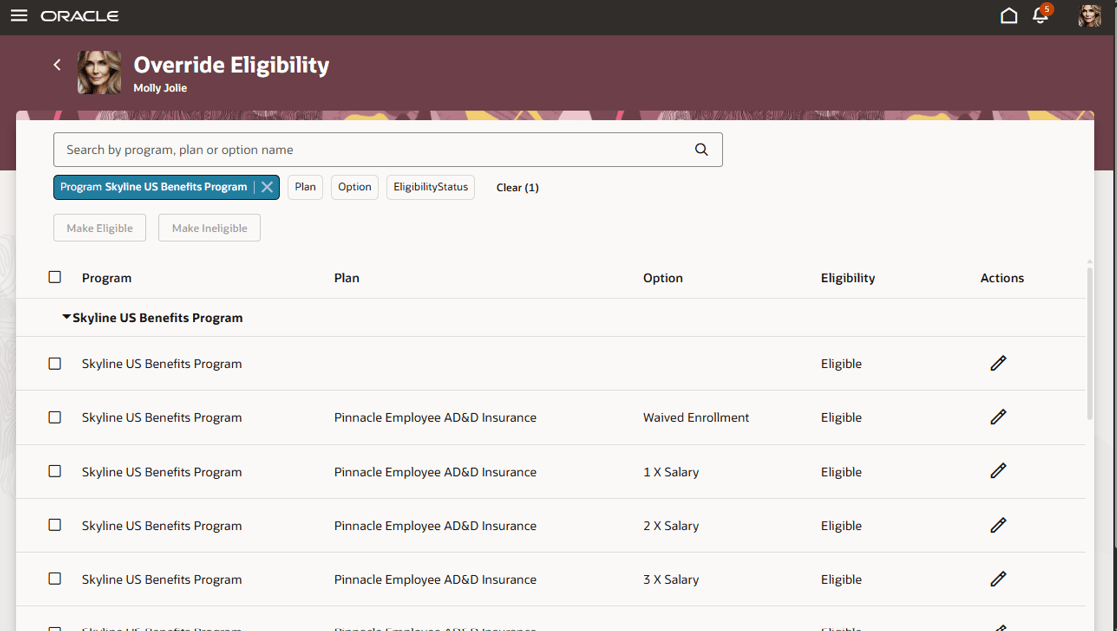

Enable Redwood Experience for the override eligibility page within the Benefits Summary Page
Explore the new eligibility override functionality within the benefits summary page recreated in the Redwood Toolset's Visual Builder Studio. This feature introduces enhanced functionality to streamline benefits administration tasks, delivering an improved and more intuitive experience.

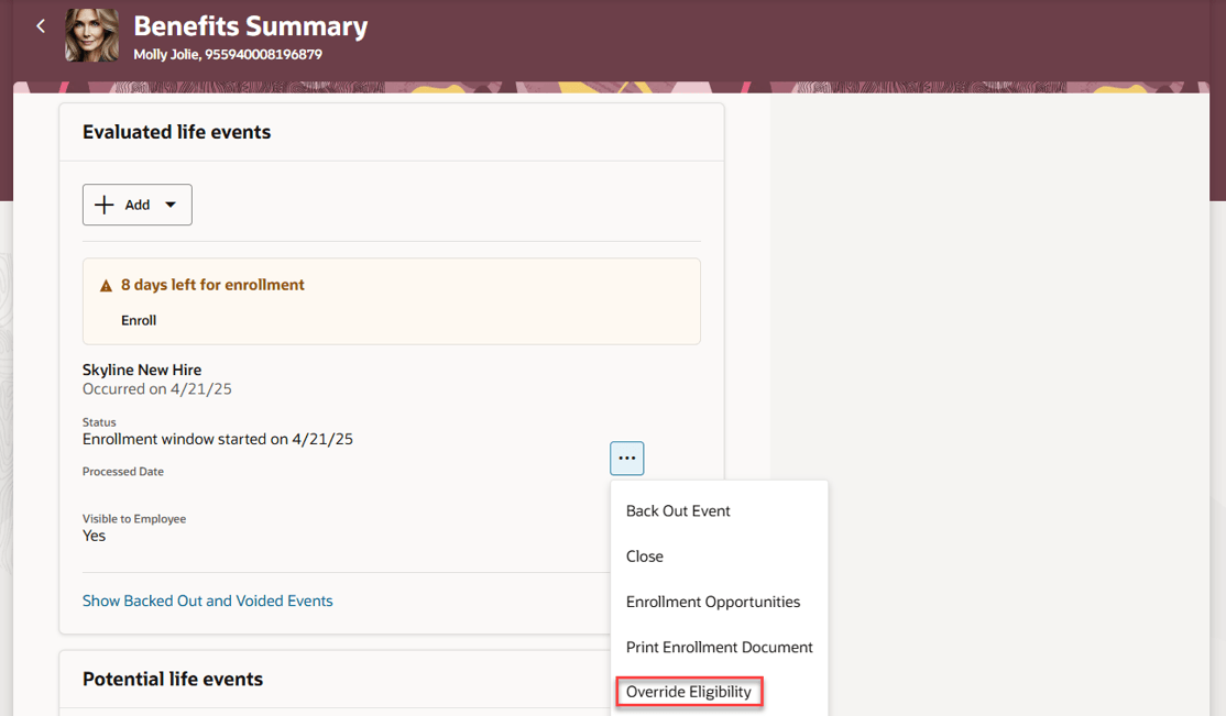

To launch the page, click Benefits Administration  >  Benefits Activity Center, and navigate to the eligibility override page.
Overrides Eligibility Page in Benefits Summary
Overrides Eligibility Page Selection from Benefits Summary
Redwood Overrides Eligibility Page
The new eligibility override functionality within the Redwood Benefits Summary page streamlines administrative tasks by enabling direct, intuitive adjustments. This reduces processing time, minimizes errors, and enhances the overall user experience for administrators managing complex eligibility scenarios.
