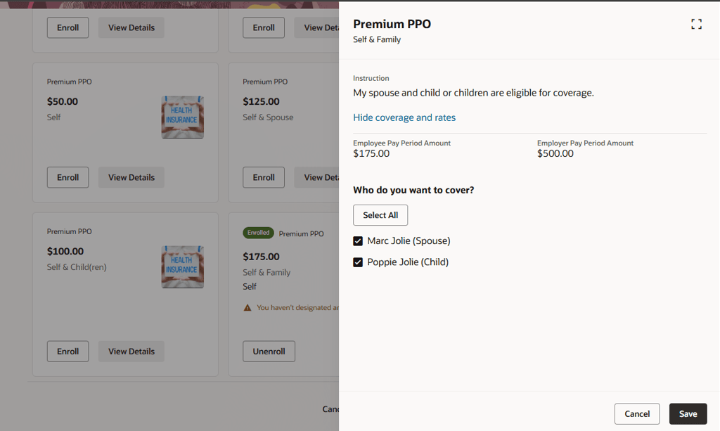

- Plan view details in the enrollment guided process.

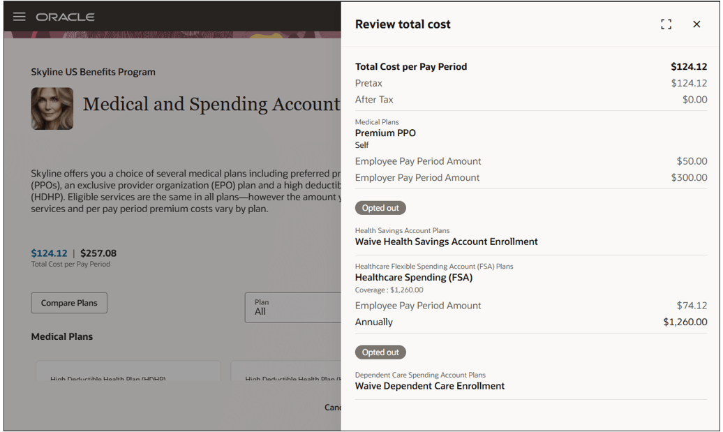

- Plan type grouping total cost in the enrollment guided process.

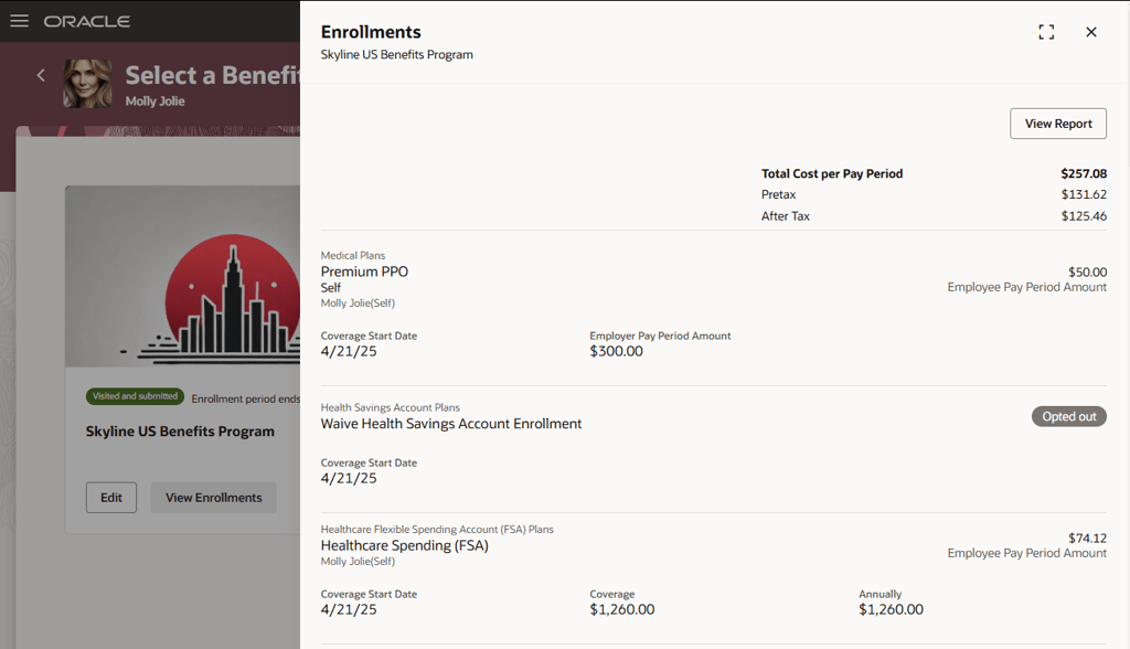

- View all enrollments in self-service benefits.
- View enrollments in benefits summary.

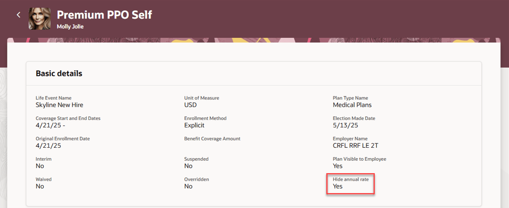

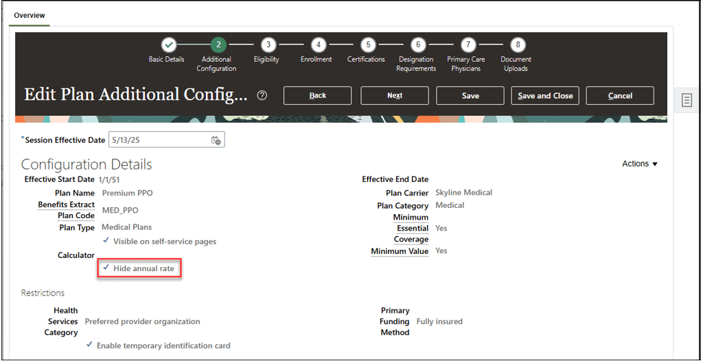

A new field named Hide annual rate is added to the Additional Configuration step in plan configuration. This field is informational and only displays if the rate is hidden in the enrollment pages. By default, the Hide annual rate field is disabled. When this field is enabled for a plan, it applies to all the annual costs for all rates for the plan and for all options under the plan.
Plan Additional Configuration: Hide Annual Rate Setup

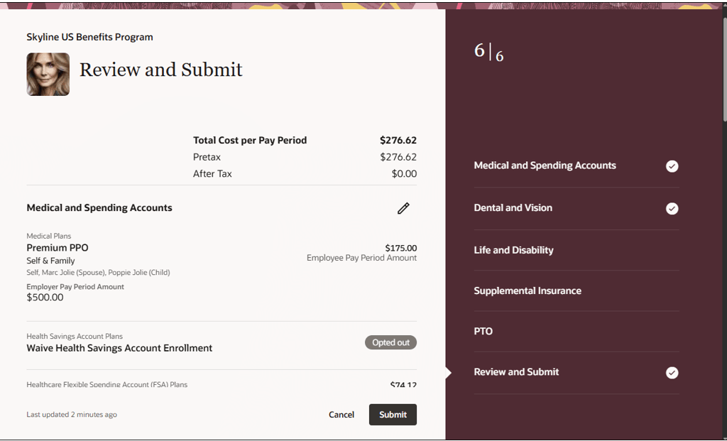

Enrollment Guided Process: Plan Type Grouping Review Total Cost
Enrollment Guided Process: Plan Details
Enrollment Guided Process: Review and Submit

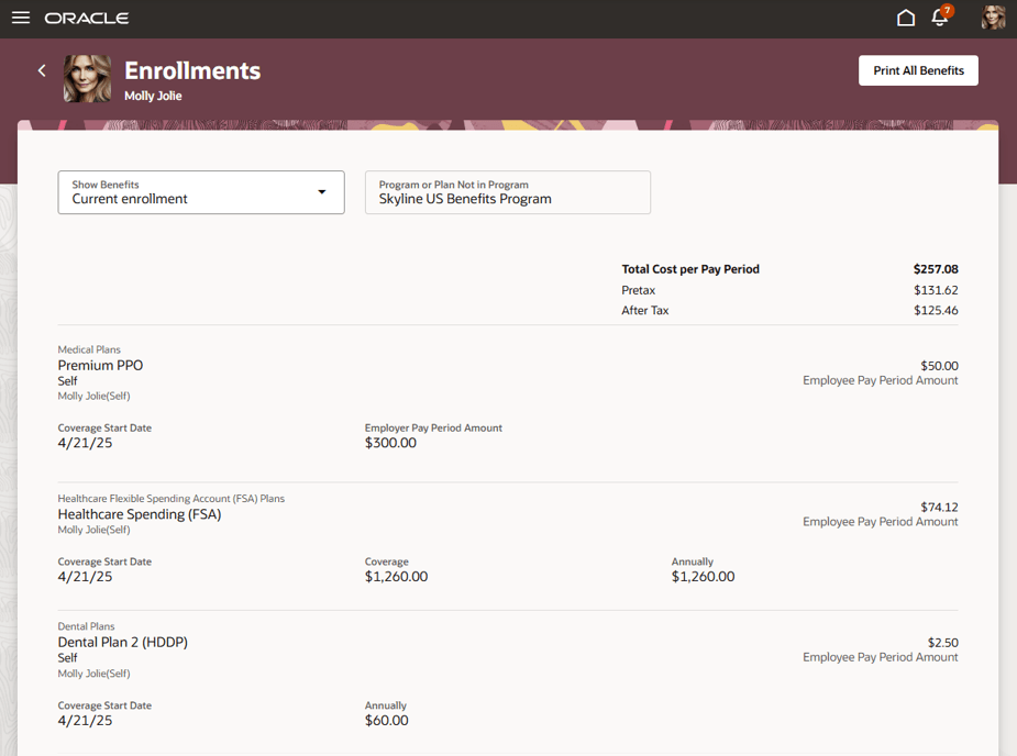

Self-Service Benefits: View All Enrollments
Benefits Activity Center: Plan Details
Benefits Activity Center: View Enrollments

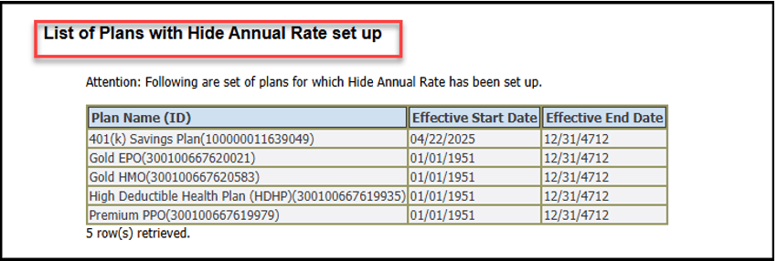

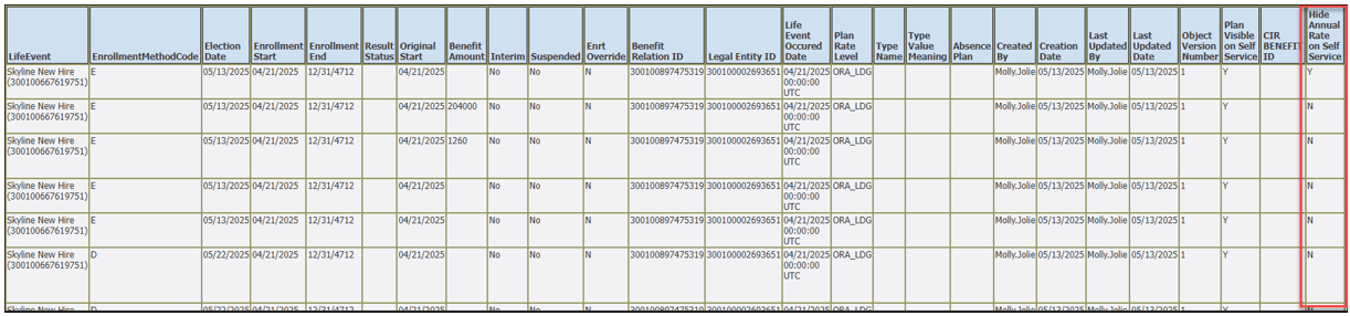

The Benefits Setup Diagnostic and Person Benefits Diagnostic reports are updated to include the hide annual rate setup.
Benefits Setup Diagnostic Report
Person Benefits Diagnostic Report: Enrollment Details
