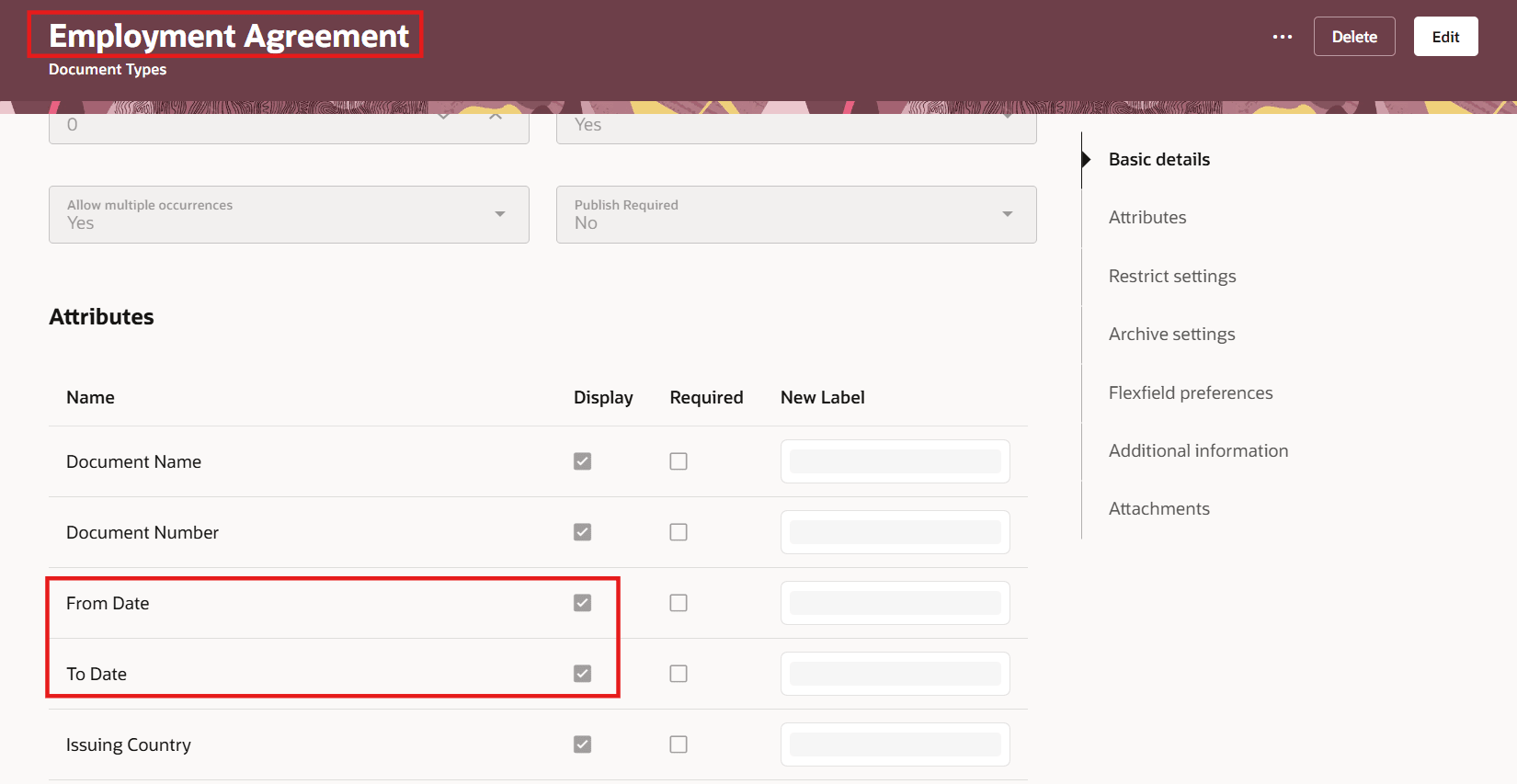

For example, the From Date and To Date for Employment Agreement Document Type are configured as Display (enabled) on the Redwood Document Types page.
Configuration on Redwood Document Type Page

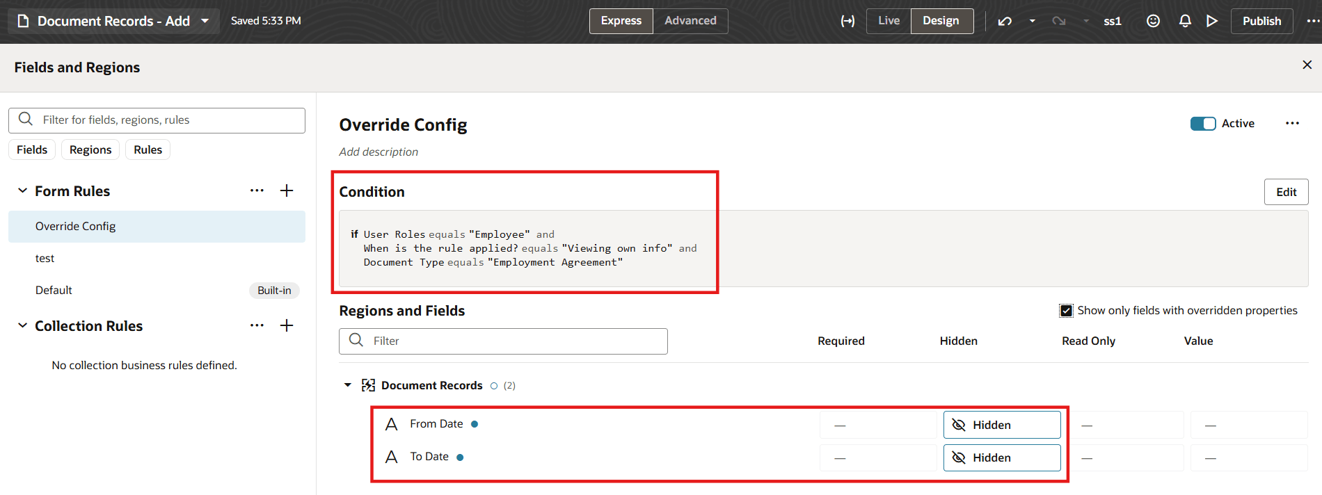

Override the From Date and To Date attributes for Employment Agreement document type as Hidden in the Business Rules pane for Employee Role.
Override Configuration using Business Rules

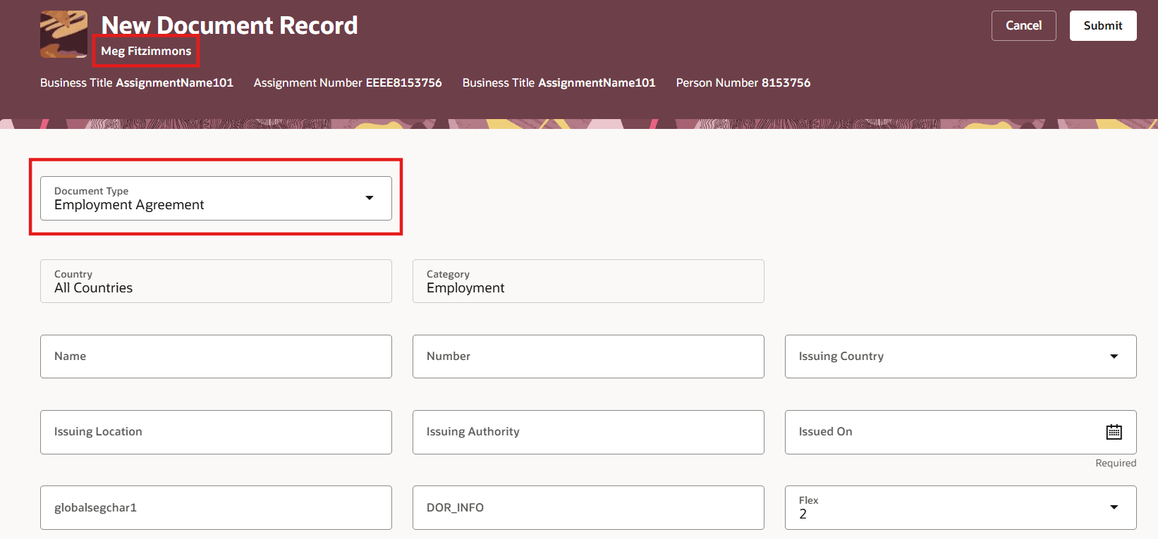

The From Date and To Date attributes will now be hidden when an employee creates a document record of Employment Agreement document type for themselves, based on the condition.
Overridden Properties Applied on Redwood Document Records Page

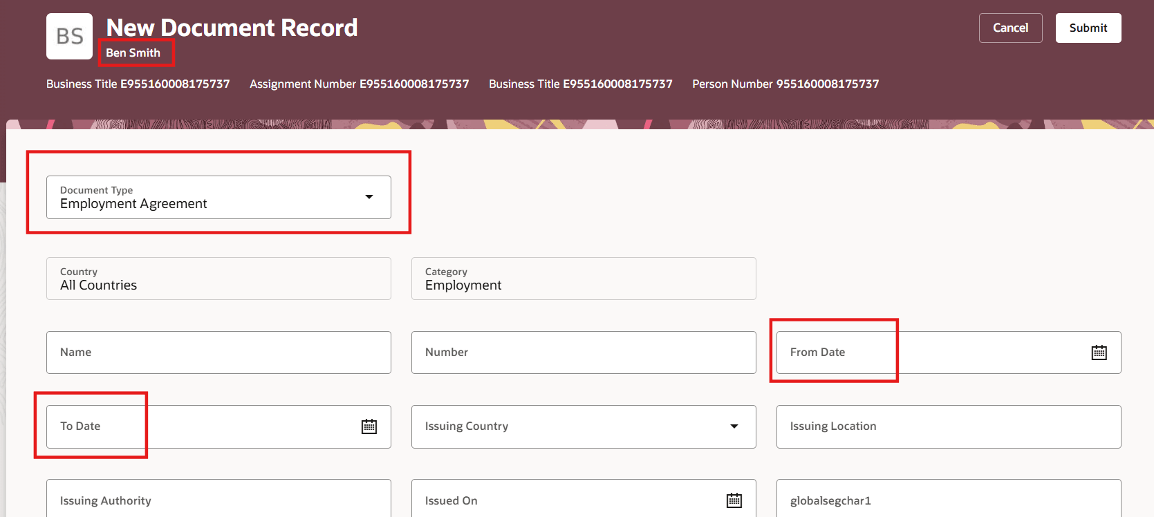

The From Date and To Date attributes will continue to be displayed when the HR Specialist creates a document record of Employment Agreement document type for an employee.
Overridden Properties Not Applied for HR Specialist
