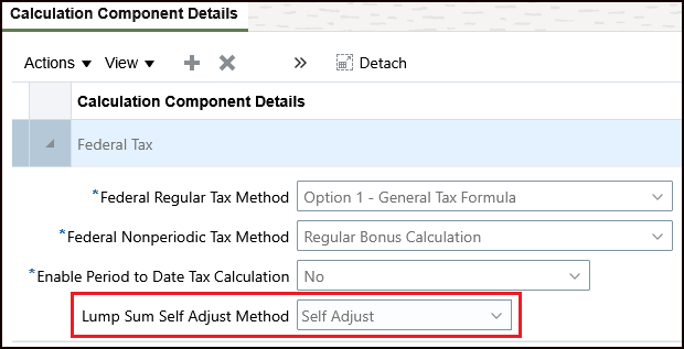

This image illustrates the new option that was added to the Federal component of the Calculation Rules for Tax Reporting and Payroll Statutory Unit card. This setting can be configured at the PSU and the TRU levels.
Lump Sum Self Adjust Method
The values for the new field are:
  • Blank (default)
  • Self Adjust
  • No Self Adjust
When processing, the system will consider lump sum settings in this order:
  • Federal Lump Sum Rate (tax card override for employee)
  • TRU Lump Sum Method
  • PSU Lump Sum Method
