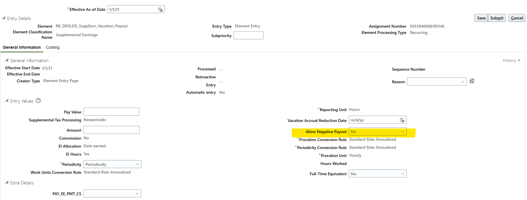

A new input value called Allow Negative Payout on the vacation payout element was created to enable the option. The values for the new option are:
  • Yes
  • No (default)
The illustration below shows the Allow Negative Payout input value available in element entries. To process negative vacation liability, set this value to Yes in the payout element entry.
Allow Negative Payout Input Value

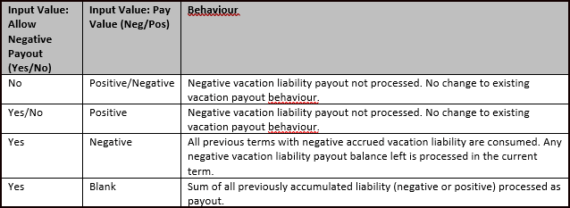

This table outlines the behaviour and highlights the differences depending on the values of the Pay Value and new Allow Negative Payout input values.
Allow Negative Payout and Pay Value Behaviour

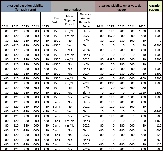

This table illustrates the negative vacation liability payout behaviour with examples.
Examples
Examples
Examples
For additional information on vacation liability processing, refer to the Administering Payroll for Canada guide, Overview of Vacation Liability Processing, on the Oracle Help Center.
