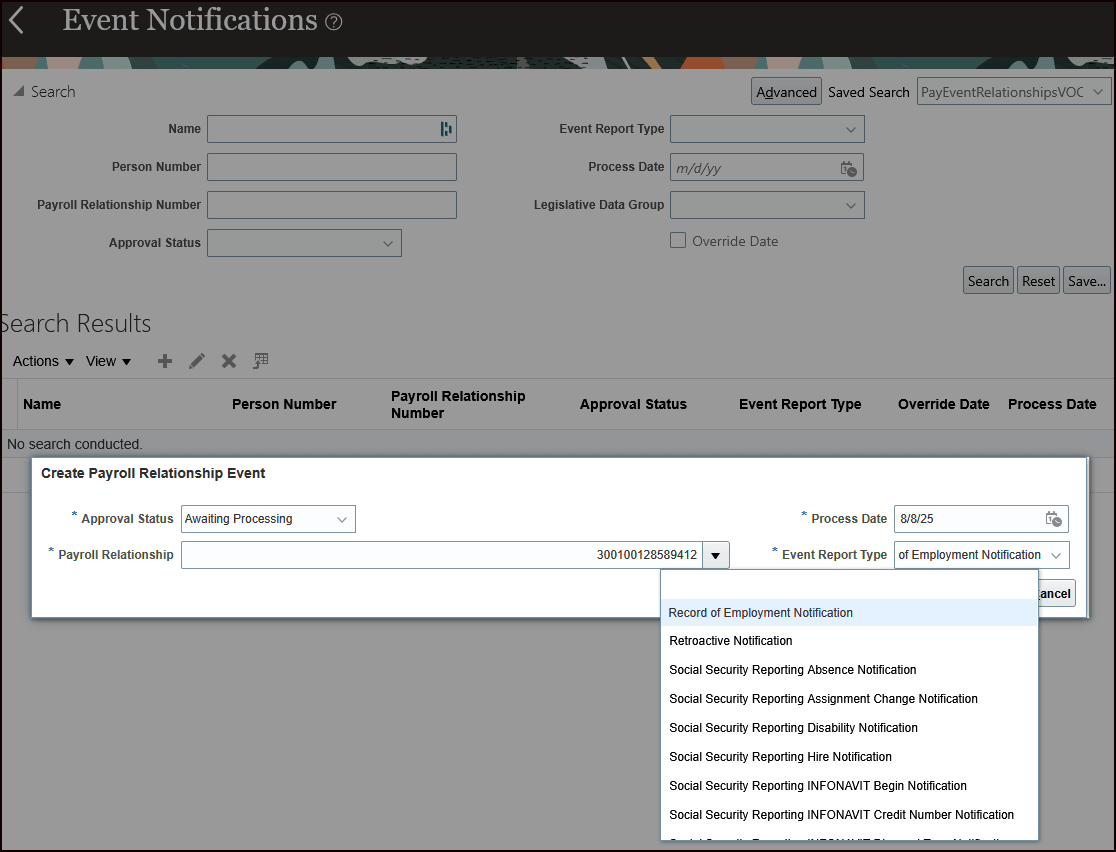

You can now manually create the event as requests are received. Also, the ROE archive can now process manually created events.
For manually created events, you must create Reporting Information calculation cards to specify the reason for issuing the ROE. For more information, please refer to the Administering Payroll for Canada guide on the Oracle Help Center (Create the Reporting Information Calculation Card topic).
This image illustrates the creation of the Record of Employment Notification event.
Record of Employment Notification Event
This feature supports the ability to generate ROEs upon request by supporting manual creation of the Record of Employment Notification events.

To create a ROE notification event, see Manual creation of ROE notification events
