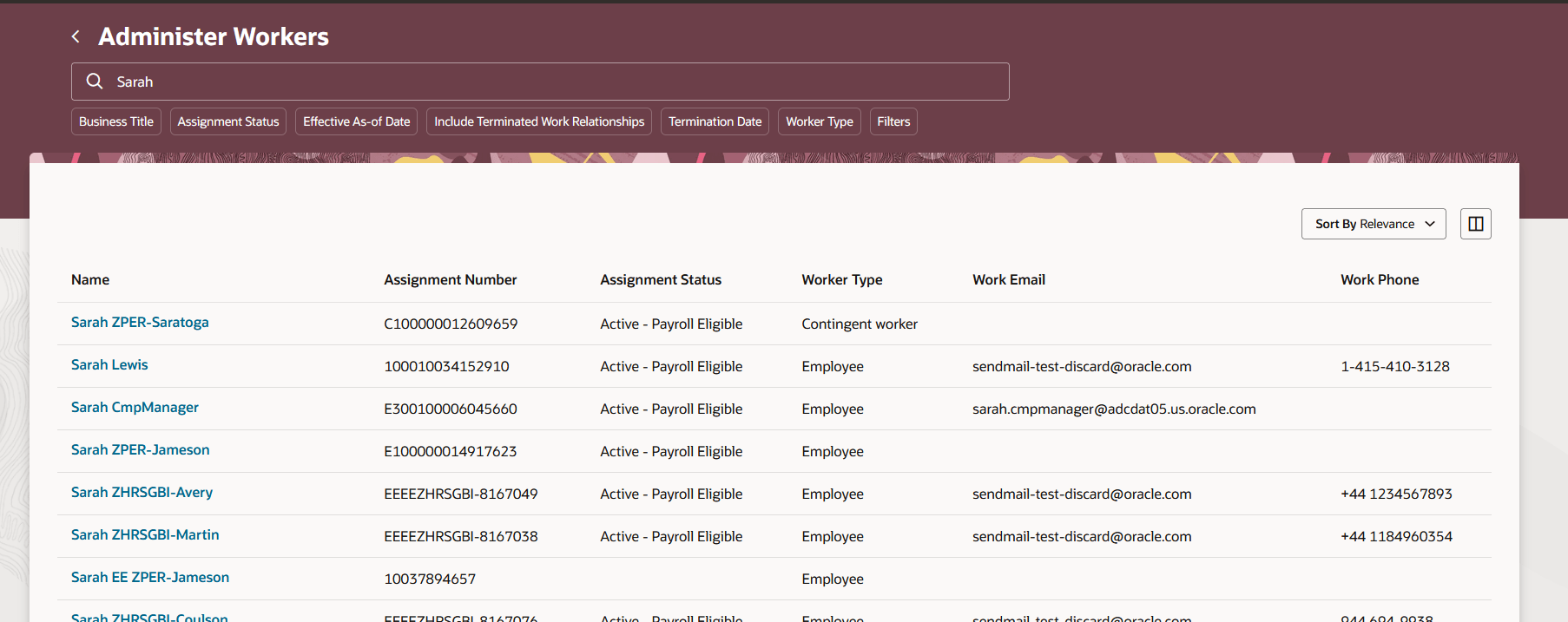

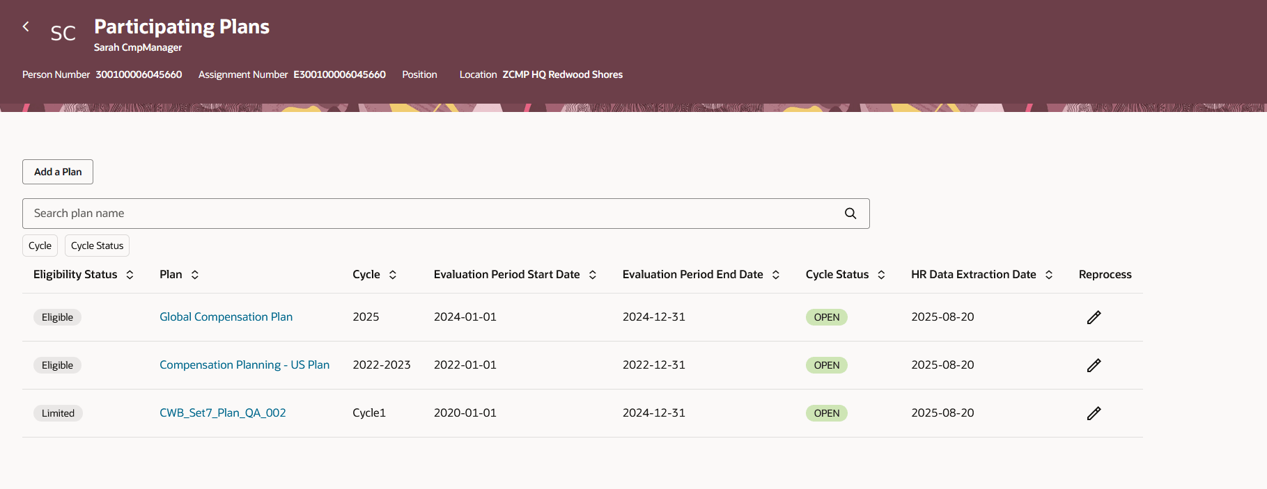

You can now let administrators use the Administer Workers Search & Select Plan pages re-created with the Redwood toolkit, when you enable the Redwood experience.
Administer Workers Plan Selection
