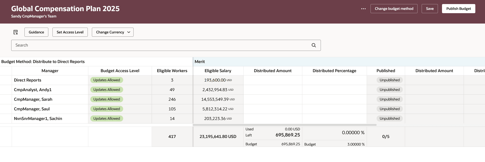

Redwood Experience for Workforce Compensation Manager-Level Budgeting

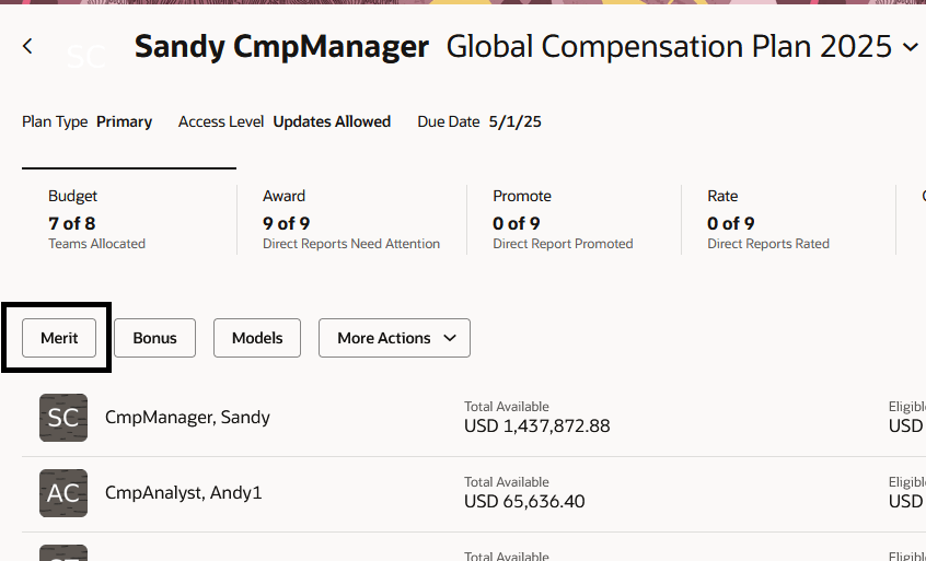

Enrich the manager experience with the new Workforce Compensation manager-level budgeting developed using the Redwood tool set when you enable it along with the Redwood experience. Managers will access the new individual budget sheets from the Budget tab in the Landing Page.
Landing Page Budget Sheet Access

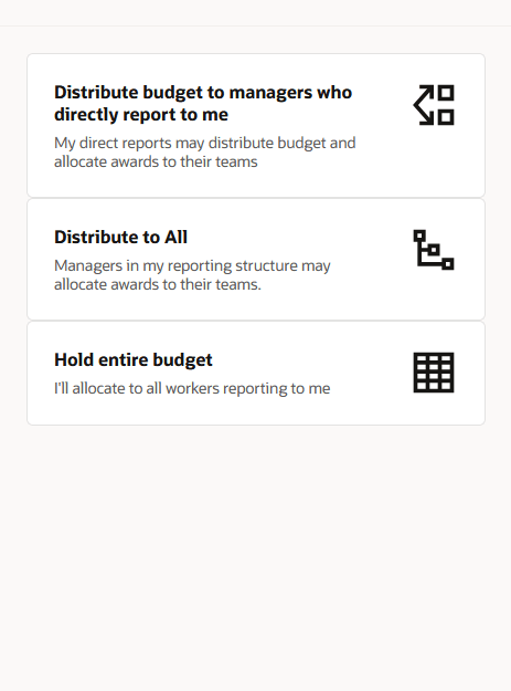

Select Budget Method

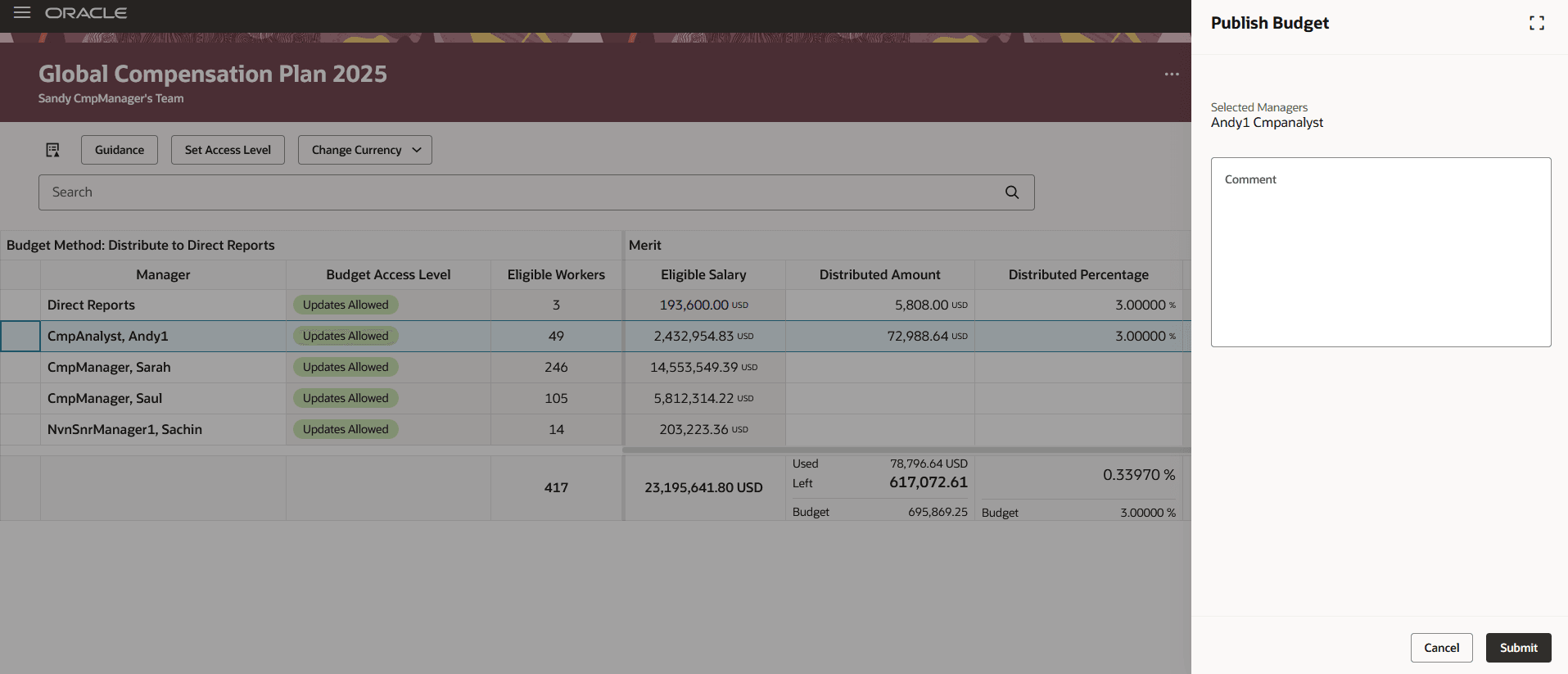

Enter Budget Values
Enter Budget Values
Publish Budget Amounts

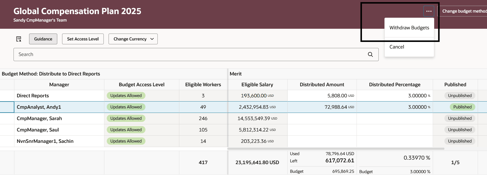

Withdrawing budgets is available in the overflow menu.
Withdraw Budgets
Withdraw Budgets

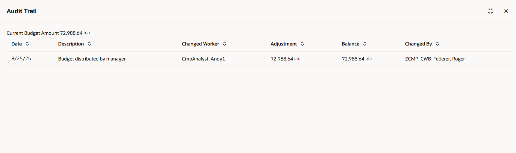

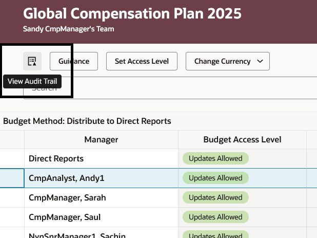

View Audit Trail Icon
Budgeting Audit Trail

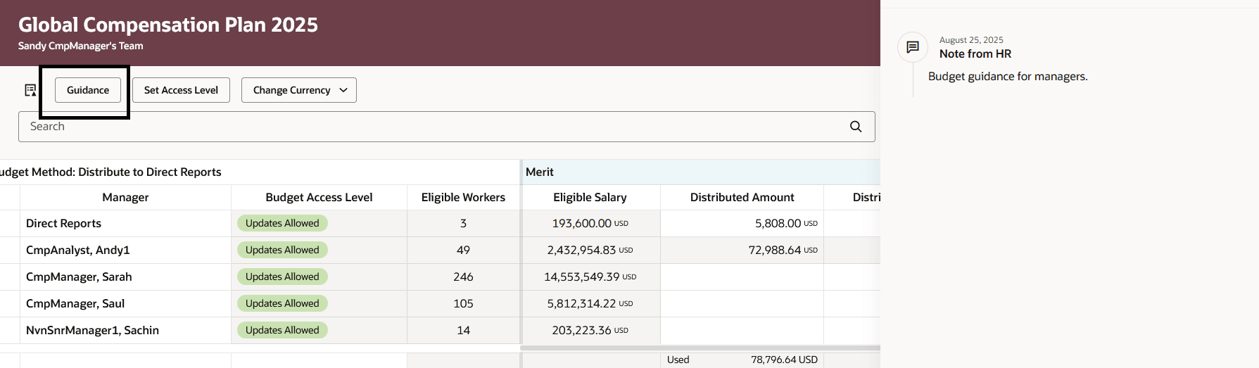

Budget sheet information has been moved to the Guidance button.
Budget Sheet Guidance
