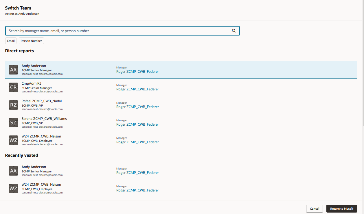

In the switch team feature, managers can search by name, email or person number. The list of managers defaults to those that are direct reports and recently visited.
Switch Team
Switch Team
When a manager chooses to revert back to themselves, they can choose the "Return to Myself" button.
